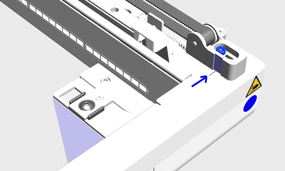

Left Y belt
Loosen the screw in the Y tensioner in the front left corner. The belt will automatically retighten itself. Check that the indicator line on the gantry is within the tolerance indicator on the Y idler. Tighten the screw again.

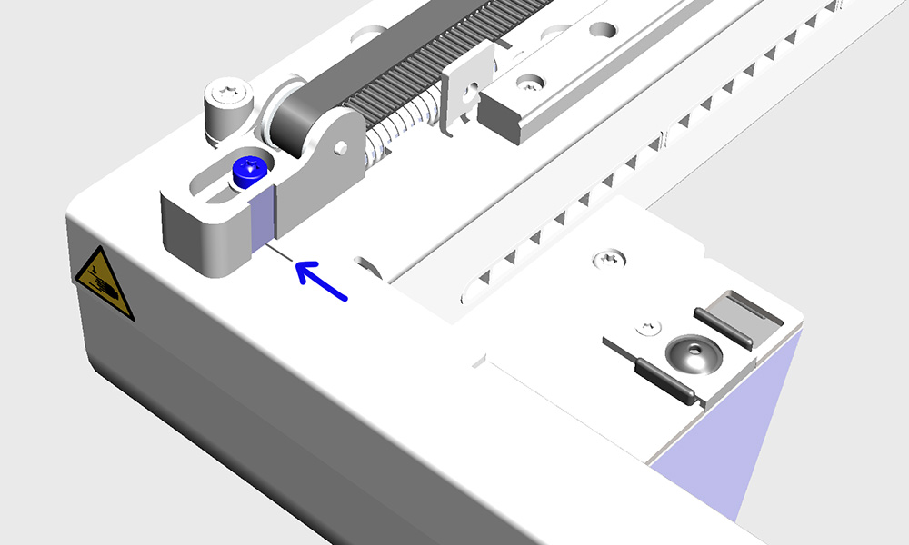

Right Y belt
Loosen the screw in the Y idler in the front right corner. The belt will automatically retighten itself. Check that the indicator line on the gantry is within the tolerance indicator on the Y idler. Tighten the screw again.

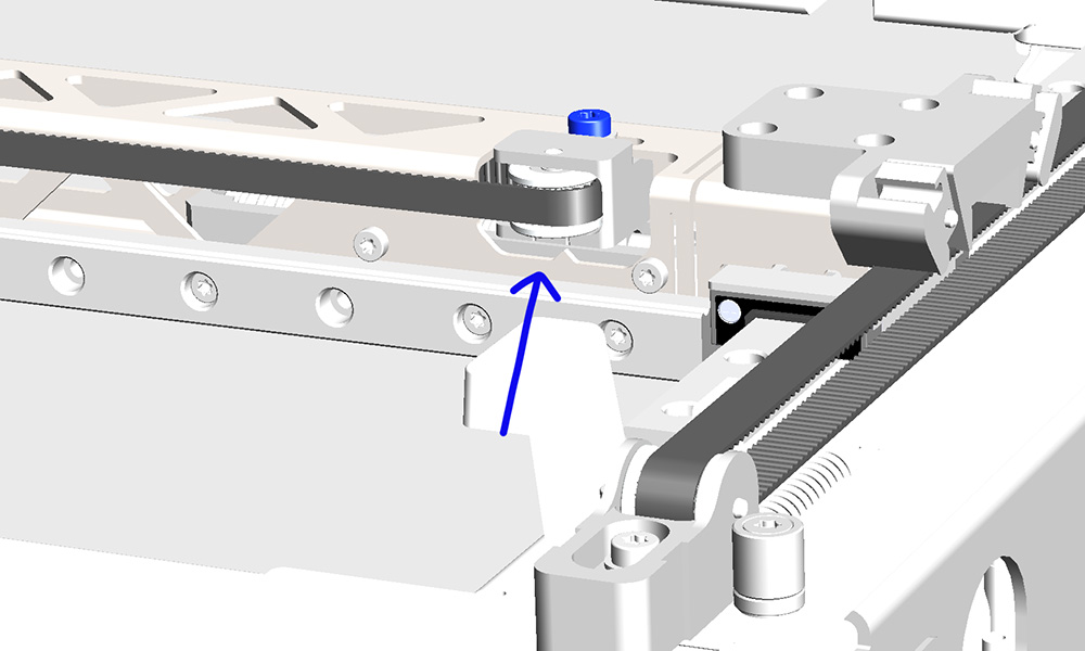

X belt
Loosen the screw on the right side of the X beam, just behind the pulley. The belt will automatically retighten itself. Check that the indicator arrow on the X beam (at the front) is within the tolerance indicator on the pulley bracket. Tighten the screw again.

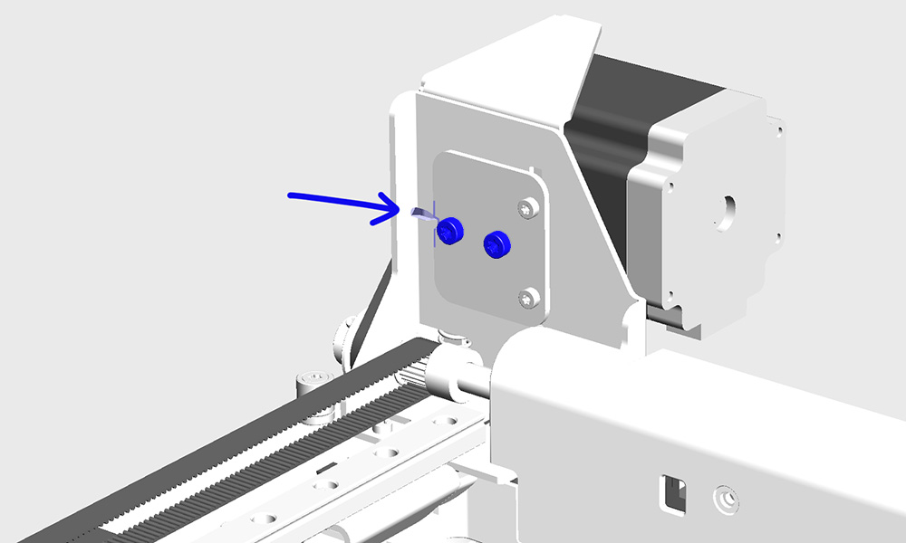

Short Y motor belt
The Y motor belt is on the left side of the gantry, in the back corner, but the tensioner is inside the Y motor bracket. Move the X beam to the front to ensure you can reach the coupling plate. Loosen the two screws in the middle of the coupling plate. The short belt will automatically retighten itself. Ensure that the indicator arrow on the motor bracket is within the tolerance indicator on the coupling plate. Tighten both of the screws again.

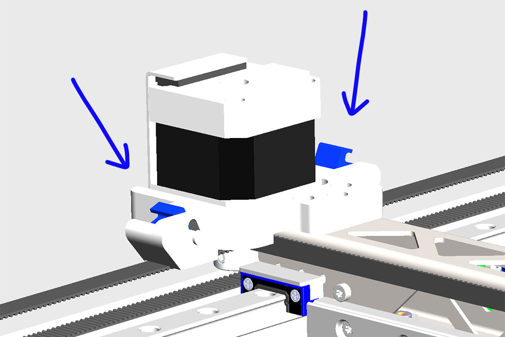

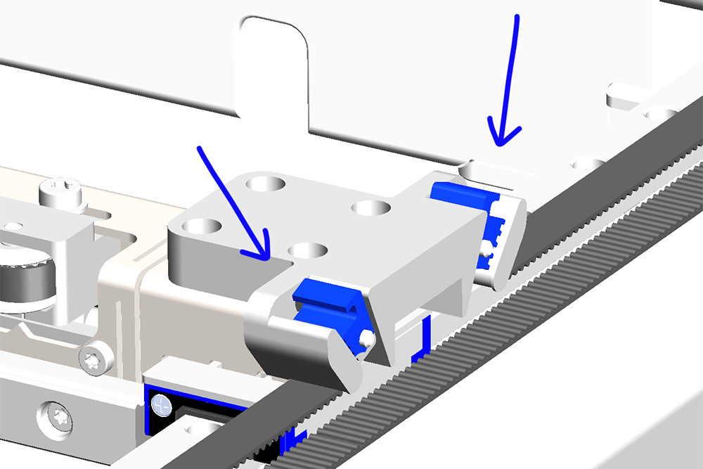

Belt wedges
The long belts are open-ended and secured with a wedge on each side. To prevent the belts from losing tension over time, the wedges must be firmly pressed down. For optimal reliability, especially for the Y belts, compressing the wedges may be needed.
Note: This is only needed once (not a regular maintenance action), and is recommended for any Factor 4 printer in use since before August 2025, or after replacing the belts. For Factor 4 Plus, it is only needed after replacing the belts.
First, loosen the screw in the Y tensioners to activate the springs. Then push down on each individual wedge to fully seat it. You can simply use your thumbs, or, if pressing with your thumbs is uncomfortable, you can use a blunt, non-damaging tool (such as the handle of a screwdriver) to assist. Do not use clamps, pliers, or any sharp or striking tools, as these may damage the component. A force of 80 N is recommended, but if a force gauge is not available, simply push down as hard as possible. Afterward, tighten the tension screws again.
