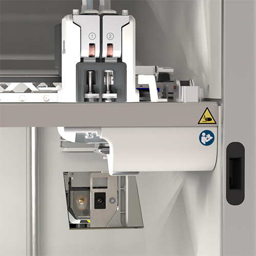

  1. The print head will move to the left side of the gantry, above the purge rubber. Hold the mirror below the purge rubber so you can see up through the hole. Select Start calibrating to proceed.
Purge-calibration-1Remove-buckets.jpgPurge-calibration-2Move-print-head.jpgPurge-calibration-3Check-mirror.jpg

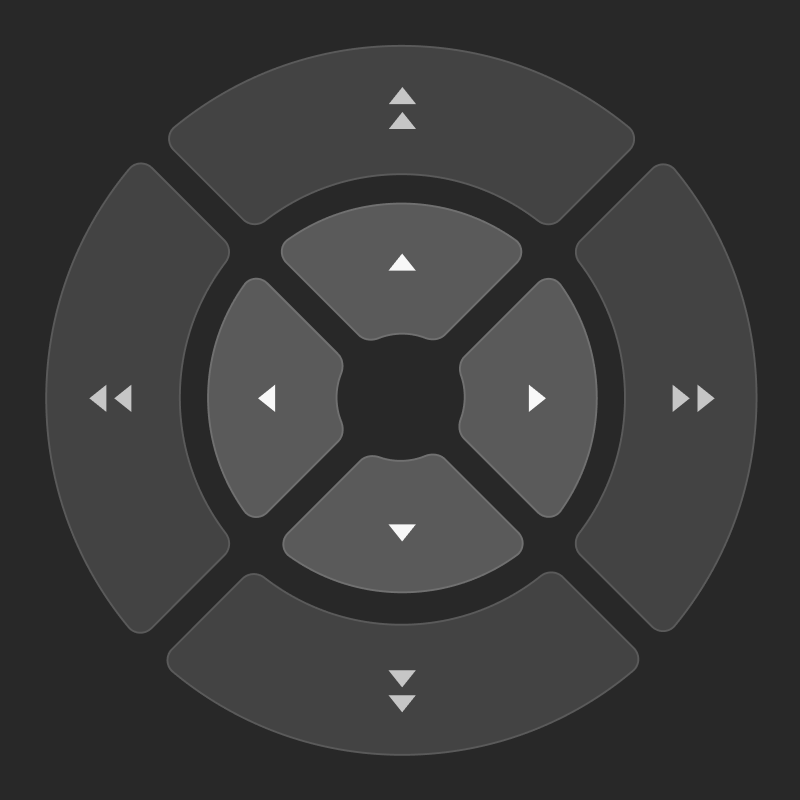

  1. Use the controls on the display to accurately position the print head until the tip of the nozzle is exactly in the center of the hole in the purge rubber.
Tip: The single arrows move the print head with small steps (0.1 mm) or press the double arrows for larger steps (0.5 mm).
  1. Use the mirror to check if the nozzle is positioned correctly and select Confirm position to proceed.
