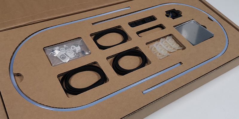

The Maintenance Kit includes spare parts, tools, and maintenance consumables:
Spare parts
The parts included in the maintenance kit are consumable items or items that are otherwise likely to be replaced within the first year of printing with the UltiMaker Factor Series printers.

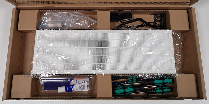

HEPA filter
The large glass-fiber HEPA (H13) filter is located in the Air Manager at the top of the printer. The filter traps Ultrafine Particles (UFPs) from the 3D printing process, ensuring a safe work environment (tested according to UL-2904).
The filter requires replacement after 3000 printing hours. The UltiMaker Factor Series printers track the filter usage and notifies the user when replacement is due.
Timing belts
The timing belts are located in the gantry. There are two (open) Y belts, responsible for moving the X beam back and forth, one (open) X belt, which is placed through the X beam and moves the print head left to right, and one (closed) short belt, which connects the Y motor to the long belts.
The belts can easily be tightened, as they might stretch slightly with extensive use. However, the belts are subjected to constant pressure and friction. As they are critical for achieving optimal accuracy, replacement is advised between one and two years of printing.
Purge rubbers
The purge rubbers are placed on either side of the gantry, above the purge buckets. When some material is primed in the buckets, the nozzle is wiped on the rubber afterward. This ensures the tip is clean before the print head moves back into the build volume.
The purge rubbers are in contact with the hot nozzles and molten material, so they will wear over time. Check them periodically and replace the rubbers when they are damaged or worn.
Nozzle cover
The nozzle cover at the bottom of the print head shields the print cores from cold airflow from the fans, which helps the print cores maintain a stable temperature while printing. The cover also helps to prevent backflow of material into the print head when something goes wrong during printing.
The heat of the nozzles may cause wear on the nozzle cover over time. It is recommended to check the quality of the cover at least once every three months. This may be necessary more frequently when printing with high-temperature materials.
Nozzle cover bracket
This is the bottom part of the print head. It is opened to change the print core configuration and it contains the nozzle cover. This bracket must close securely to prevent failures. If this is no longer the case or when the bracket is damaged otherwise, replace it before you continue printing.
Always ensure that the silicone nozzle cover is correctly installed in the bracket before starting a new print job.
Bowden tubes
The Bowden tubes guide the filament to the print head. The UltiMaker Factor Series printers contain various Bowden tubes throughout the extrusion path, but the tubes connected to the print head are most prone to wear. This is because they are located inside the heated chamber, are subjected to movement, and may have to be removed from the print head routinely for print core cleaning.
The filament must be able to pass through the tubes without friction, and the Bowden tubes must be securely attached to the print head. If this is no longer the case, replace the tubes for improved reliability.
Fasteners
The Bowden tubes are secured using tube coupling collets, wave washers, and clamp clips. These small items are critical for the reliable movement of the filament through the machine. Although these parts do not tend to wear under normal conditions, while performing maintenance and repair actions they can easily be misplaced.
The maintenance kit contains a convenient collection of spares.
Collet press cover
This part conveniently releases the pressure on the Bowden tubes in the print head when pressed. It is placed at the top of the print head, over the tube coupling collets. Press down on the lip while pulling the corresponding Bowden tube upward, for example during the print core cleaning process.
This maintenance kit contains a spare if this part is damaged or lost.

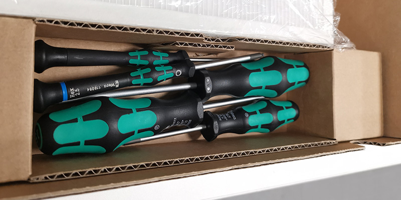

Screwdrivers
The UltiMaker Factor Series printers use different screws and bolts to secure components and modules. This maintenance kit contains the screwdriver types for the most common repair and maintenance actions:
Hex 2, Hex 2.5, Torx 9, Torx 15, and Torx 20
Consumables
Keeping the printer clean and well-lubricated is critical to the performance of the UltiMaker Factor 4. The maintenance kit contains the most important consumables for completing regular maintenance tasks.
Cleaning filament
This is a pack of 10 sticks of 2.85 mm polycarbonate filament used for cleaning the print cores. The UltiMaker Factor Series printers contain an assisted cleaning procedure in the firmware. Cleaning filament can be used for preventive maintenance as well as removing more severe blockages in the print cores.
Grease for lead screw
The lead screw is connected to the Z motor and controls the movements of the Z stage. To ensure smooth movement of the Z stage, it is recommended to periodically clean the lead screw and apply new grease. Move the build plate up and down to distribute the lubricant.
Lubricant for linear rails
This is intended for the gantry, to lubricate the linear guide on which the print head carriage is mounted. The lubricant is supplied in a convenient syringe for easy and accurate application.
