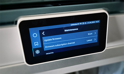

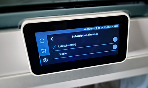

Touchscreen menu
  1. In the Options menu (gear icon), select Maintenance.
  2. Select Firmware subscription channel.
  3. Change to your preferred update channel and exit the menu.

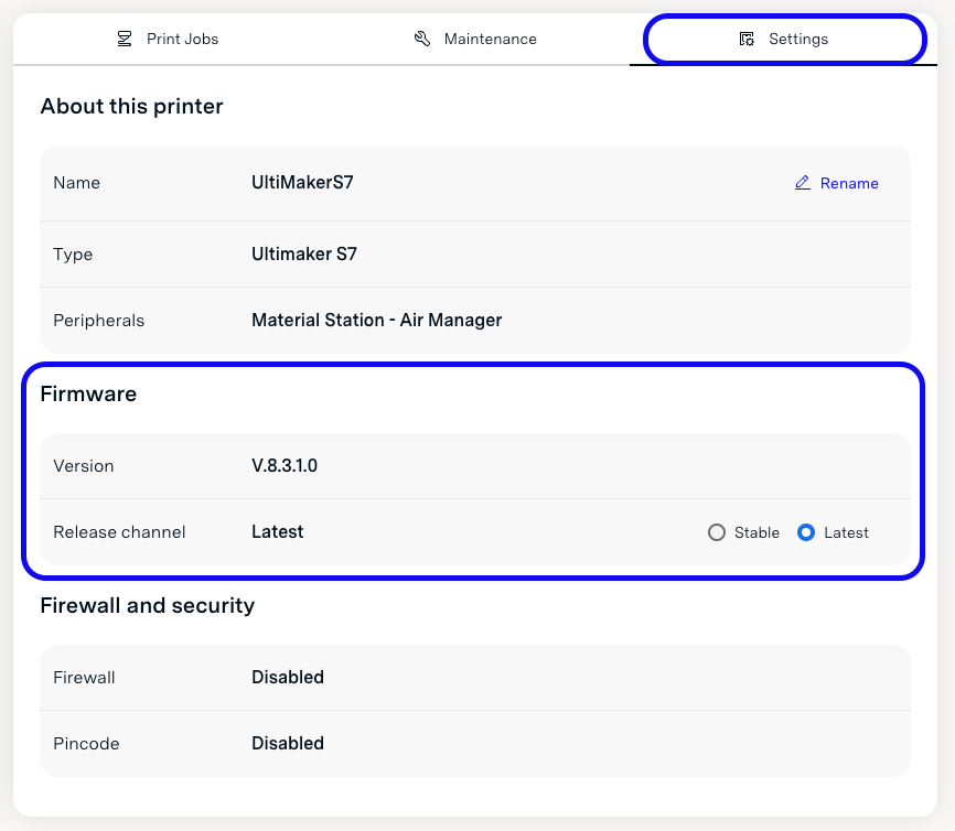

Digital Factory
Tip: If your printers are not yet connected to the UltiMaker Digital Factory, learn how to do so on this page.
In the Digital Factory, go to the Printers tab and click on the printer for which you want to change the subscription channel.
In the Settings panel on the right, you can see the currently installed firmware version and the release channel. Click the circle next to Stable or Latest if you want to change the channel. This may take a moment to update.
