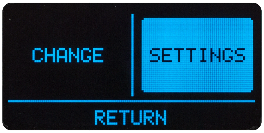

  1. Turn on the printer using the power switch at the back.
  2. Use the button to select the Material menu and click to enter.
  3. In the Material menu, select the option Settings.

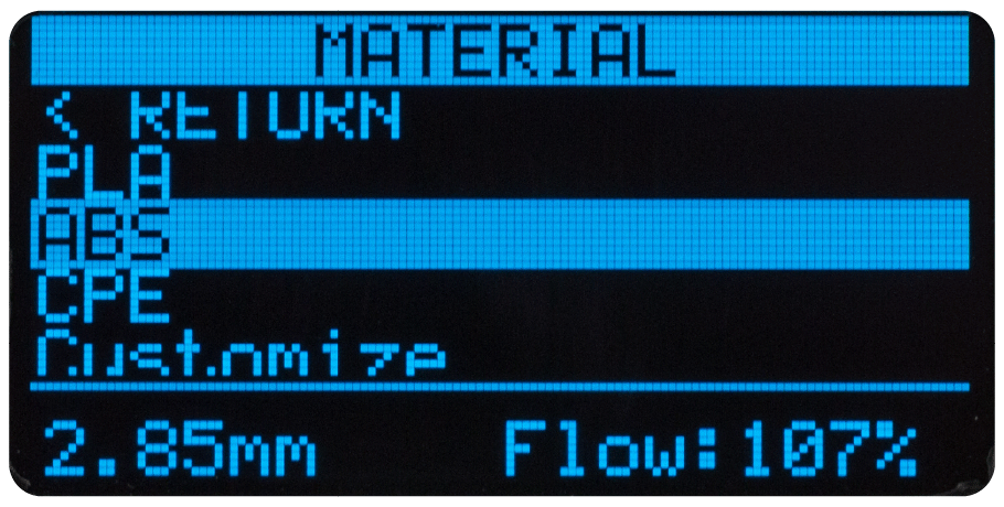

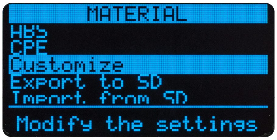

  1. The Settings menu shows a list of available materials in the machine. This list shows all supported materials by default.
  2. Scroll down the list to the Customize option and click to select it.

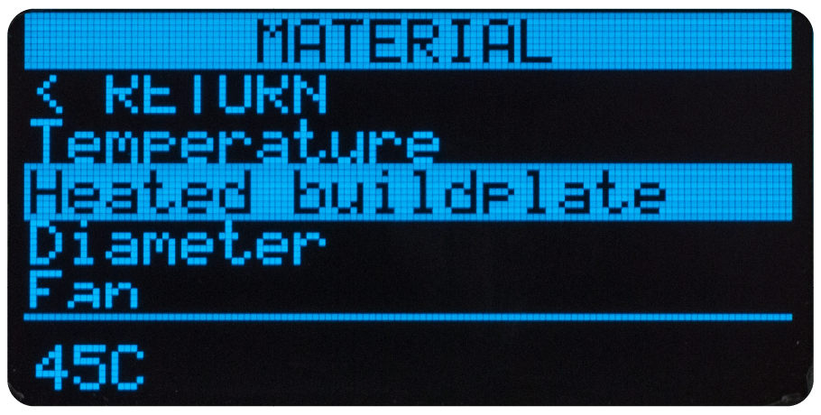

  1. This menu shows all material settings that can be adjusted: (nozzle) temperature, build plate temperature (this is not available on the UltiMaker 2 Go), filament diameter, fan speed, and flow rate. Click on one of the settings to start editing it.
  2. Rotate the button to change the selected setting. Note that the previous setting is visible at the bottom of the screen. Click the button to confirm the new setting value and return to the settings list.

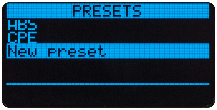

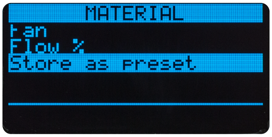

  1. To save the settings, click Store as preset.
  2. Overwrite one of the existing materials by selecting them, or create a new material by clicking New preset. The name of the new profile will be Custom_#. When you overwrite one of the existing materials, the name will stay the same.

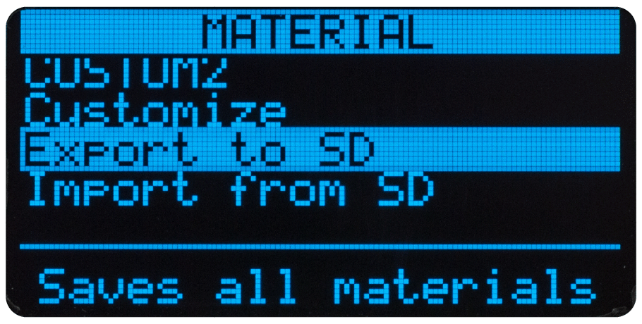

  1. At the bottom of the list are two options: Export to SD and Import from SD. Start by exporting the current list of materials.
  2. A message appears: Saved the materials to the SD Card in MATERIALS.TXT. This indicates that the materials were exported successfully.

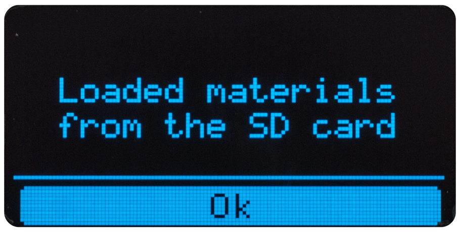

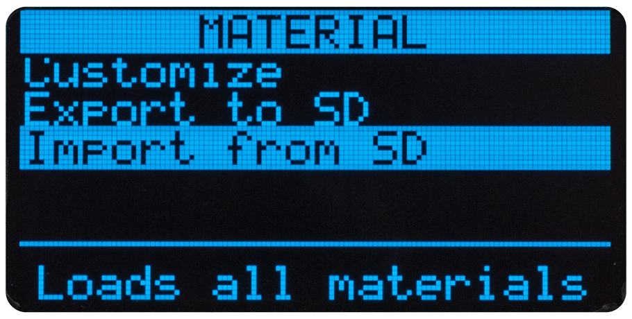

  1. Scroll down and click Import from SD.
  2. A message is displayed: Loaded materials from SD card. Click Ok.
Scroll through the list of materials to verify you correctly imported your material new settings. You can now continue printing with your updated settings and/or new materials!
