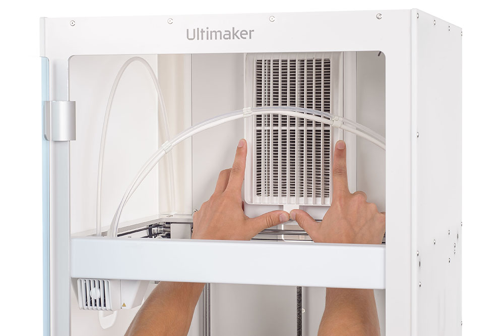

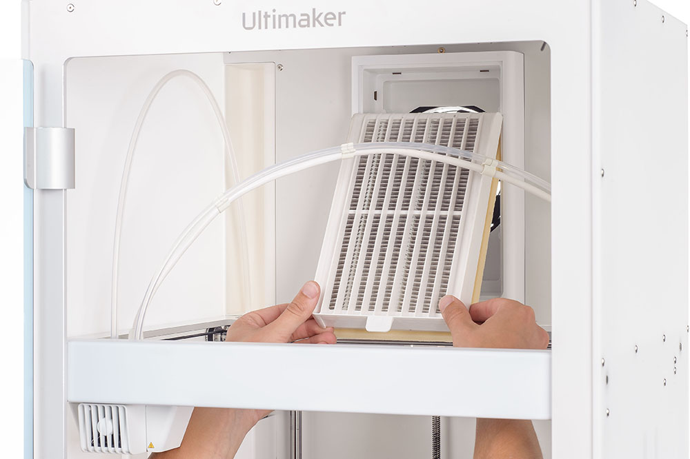

Place the Air Manager filter
Unpack the Air Manager filter and ensure that the UltiMaker S7 door is still open. You can move the print head to a corner at the front of the printer to keep it out of the way. Align the Air Manager filter with the housing, with the tab at the bottom. Gently push the filter completely into the filter housing.

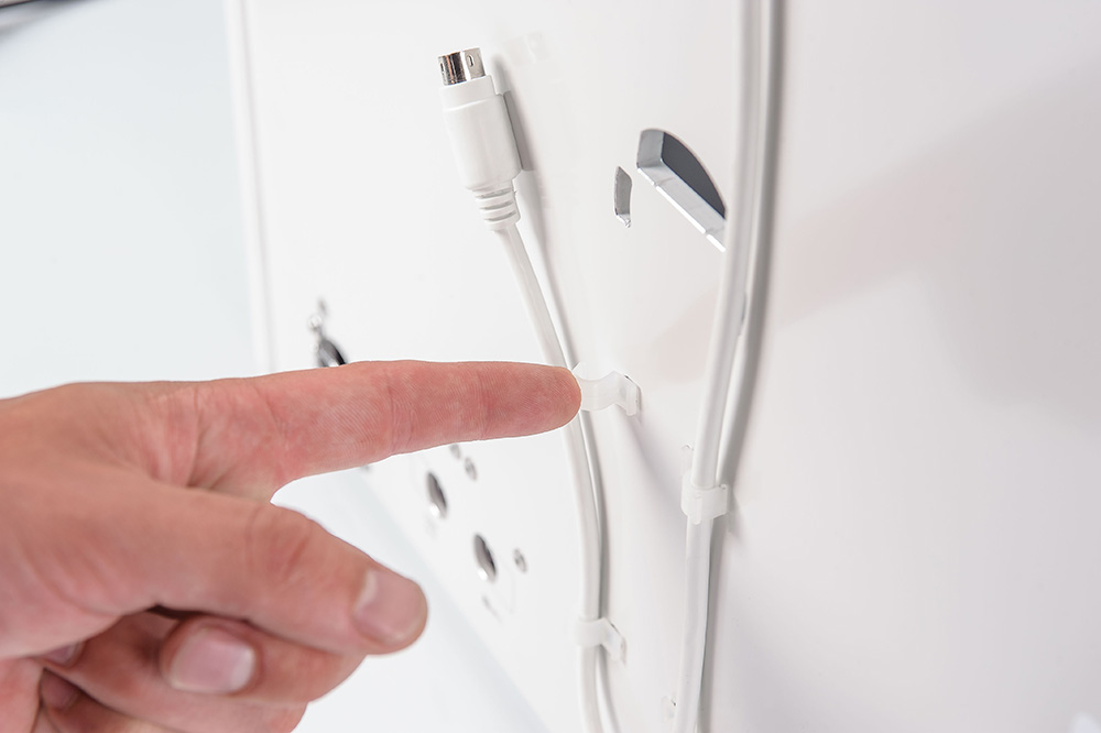

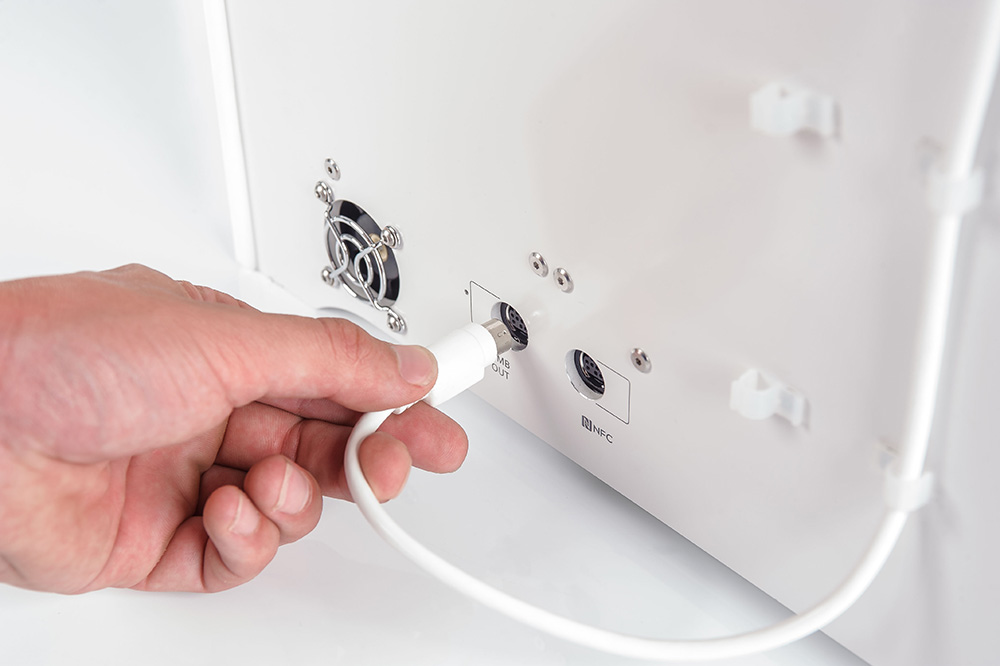

Connect the Air Manager cable
Now close the door and move to the back of the printer. The Air Manager cable is already connected at the top, and the cable is fixed behind the cable clips in the back panel. Remove the bottom end of the Air Manager cable from the clips and connect it to the UMB OUT port.

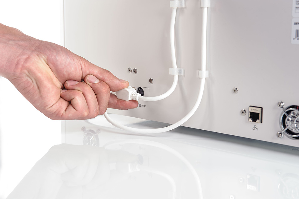

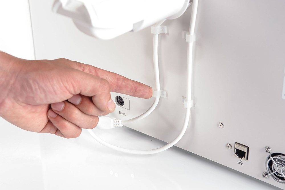

Place and connect the NFC spool holder
Take the spool holder, insert it into the back panel, and push it down until it snaps into place. Secure the cable behind the two cable clips in the back panel directly underneath the spool holder. Connect the cable to the NFC socket at the back of the printer.

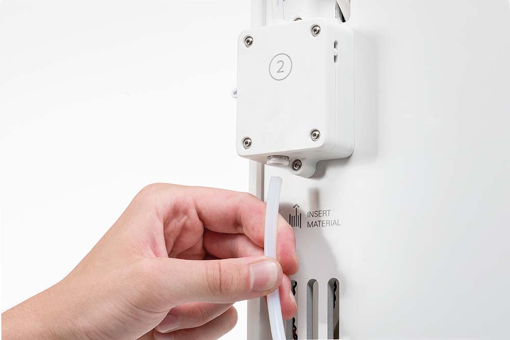

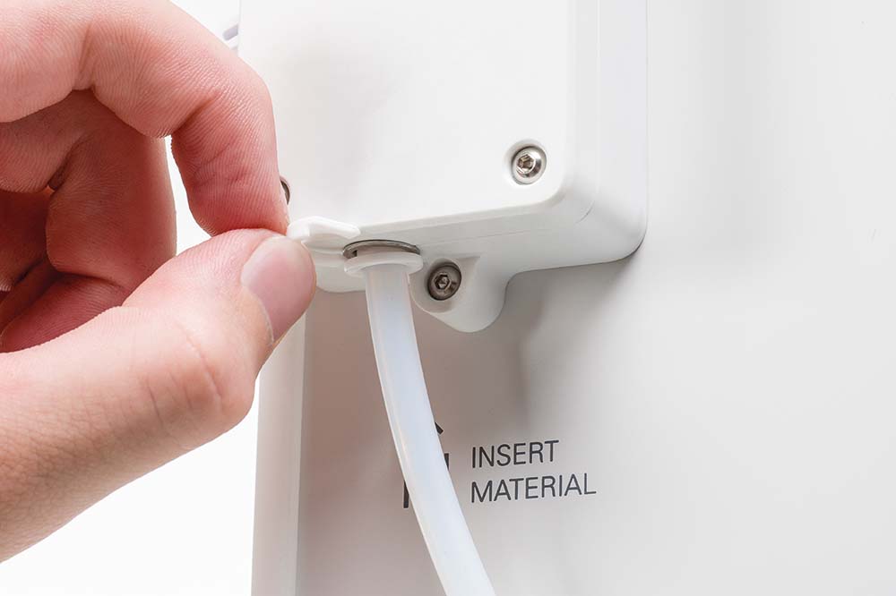

Connect the Material Station Bowden tubes
Material-Station-icon.pngThis section describes how to connect the Bowden tubes of the Material Station to the feeders of the UltiMaker S7. If you do not have a Material Station, skip this section.
Insert a tube coupling collet in the bottom of each feeder of the UltiMaker S7. Insert the left Bowden tube of the Material Station into the left feeder, and the right Bowden tube into the right feeder. Secure the Bowden tubes with clamp clips.

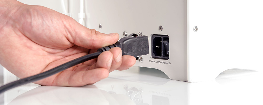

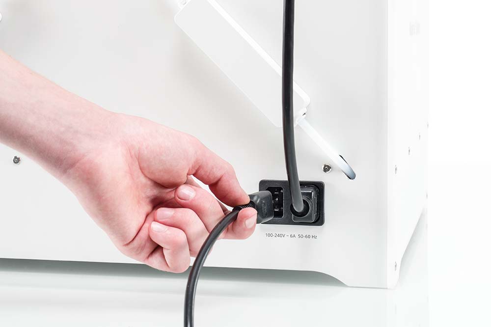

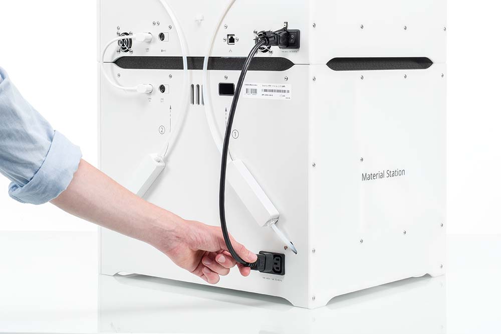

Connect the power cable
Lastly, take the power cable and insert it into the power socket at the back of the printer. Plug the other end of the cable into a wall outlet.
Caution: A mains socket with protective earth/ground terminal must be used. Make sure that the building installation has dedicated means of over-current and short-circuit protection.
Material-Station-icon.pngIf the UltiMaker S7 is installed in combination with a Material Station, first connect the power extension cable. Connect one side to the printer and the other to the double power entry port of the Material Station. Connect the power cable to the Material Station and the other end to a power outlet.
