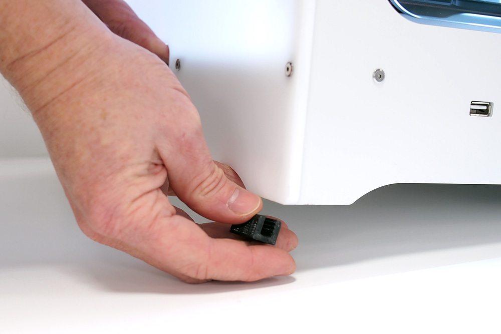

1. Anti-slip feet
Carefully tilt the printer and place the anti-slip feet around the bottom of the frame panels.

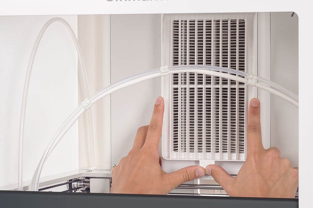

2. Air Manager filter
Open the door, align the Air Manager filter with the housing, and gently push it into place.

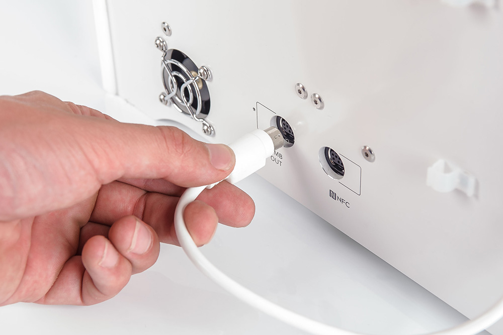

3. Air Manager cable
At the back of the printer, connect the Air Manager cable to the UMB OUT port.

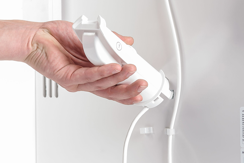

4. Spool holder
Insert the spool holder into the back panel and push until it snaps into place.

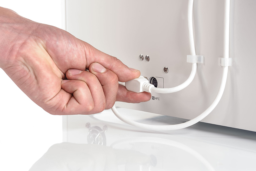

5. Spool holder cable
Connect the spool holder cable to the NFC socket and secure it behind the cable clips.

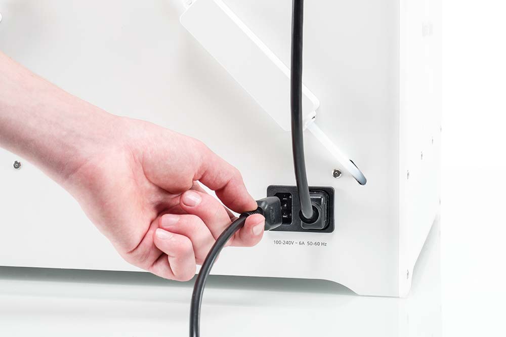

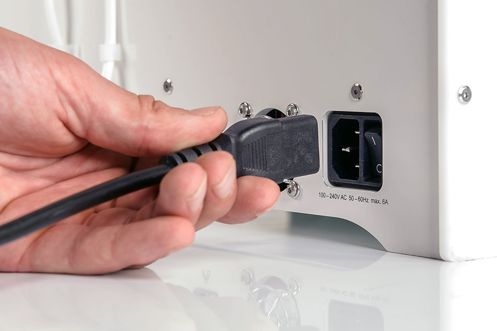

6. Power cable
Connect the power cable to the printer and the other end to a power outlet.
Caution: A mains socket with a protective earth/ground terminal must be used. Make sure that the building installation has dedicated means of overcurrent and short-circuit protection. Use a circuit breaker with a current rating not exceeding 16A (for 220-240 VAC circuits) or 20A (for 100-120 VAC circuits).

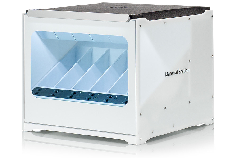

Setup with Material Station
If the UltiMaker S8 is going to be used in combination with the Material Station, you do not need the spool holder, but you need several accessories included with the Material Station instead.
Tip: Check the Material Station quick start guide, or visit this page for detailed information about the Material Station installation.
1. Place Material Station
First place the Material Station on the installation surface.

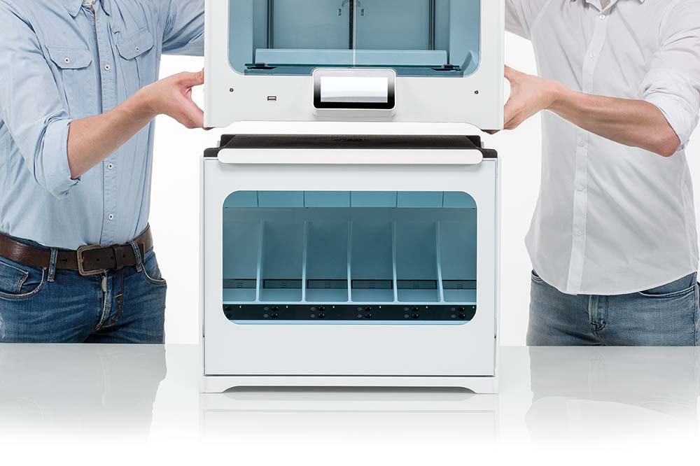

2. Place UltiMaker S8
With two people, lift the UltiMaker S8 and place it on top of the Material Station.

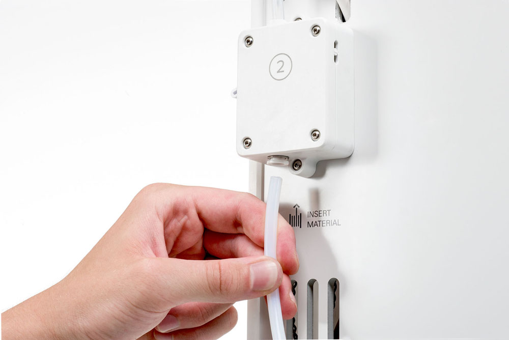

4. Bowden tubes
Insert the tube coupling collets and Material Station Bowden tubes into the UltiMaker S8 feeders.

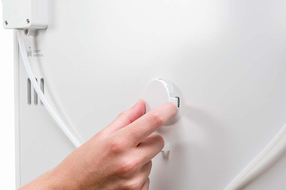

5. Spool holder cap
Place the spool holder cap into the hole for the spool holder
in the S8 back panel.

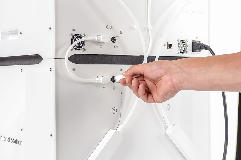

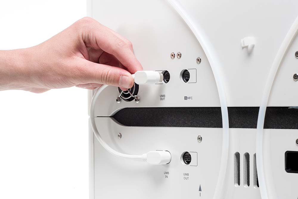

6. Material Station cable
Connect the short Material Station cable from UMB IN on the Material Station to UMB OUT on the printer.
7. Air Manager cable
Connect the Air Manager cable to the UMB OUT port on the Material Station.

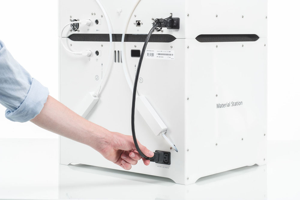

9. Power cable
Connect the power cable to the Material Station and the other end to a power outlet.
