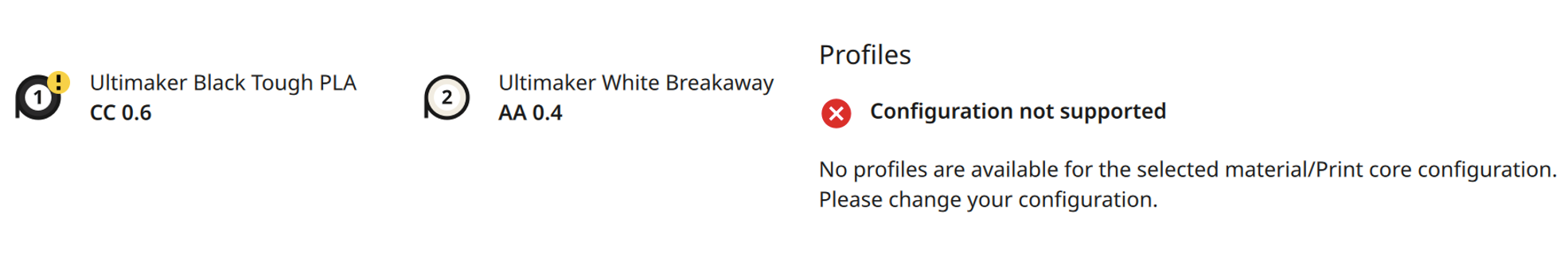

UltiMaker Cura contains a wide range of preset print profiles for UltiMaker materials and print core or nozzle combinations. Using these profiles allows quick and simple slicing for a variety of applications. In order to use these default profiles, it is important to have selected a supported configuration. When there is no compatible profile for the configuration you selected, UltiMaker Cura shows an exclamation mark in the Material menu and a Configuration not supported message in the Print settings menu.

There can be a few reasons why a profile is not supported. To obtain a supported profile, it is important to check the following factors:
1. Material and print core combination
The print core types are optimized for different materials. Also, not all materials can be printed with all nozzle sizes.

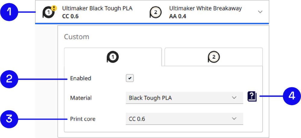

When you want to make a single extrusion print, it is recommended to disable the unused extruder. Select either Extruder 1 or Extruder 2 in the Configuration panel, and click the Enabled checkbox to disable this extruder. This is important, because sometimes the print settings are taken from the second extruder, while this is not intended. To list some examples:
  • Build plate temperature. The highest build plate temperature of both extruders is chosen.
  • Initial layer height. The highest initial layer height of both extruders is chosen.
  • Selection of layer heights. Only mutual layer heights, i.e. layer heights that both materials have a supported profile for, can be chosen. This is also important when using dual extrusion with two different print core sizes. Find more information about this below in section 3.
Tip: When you slice a single-extrusion print with both extruders still enabled, Cura will detect this and prompt you to disable the unused extruder. This prevents any of the problems listed above.

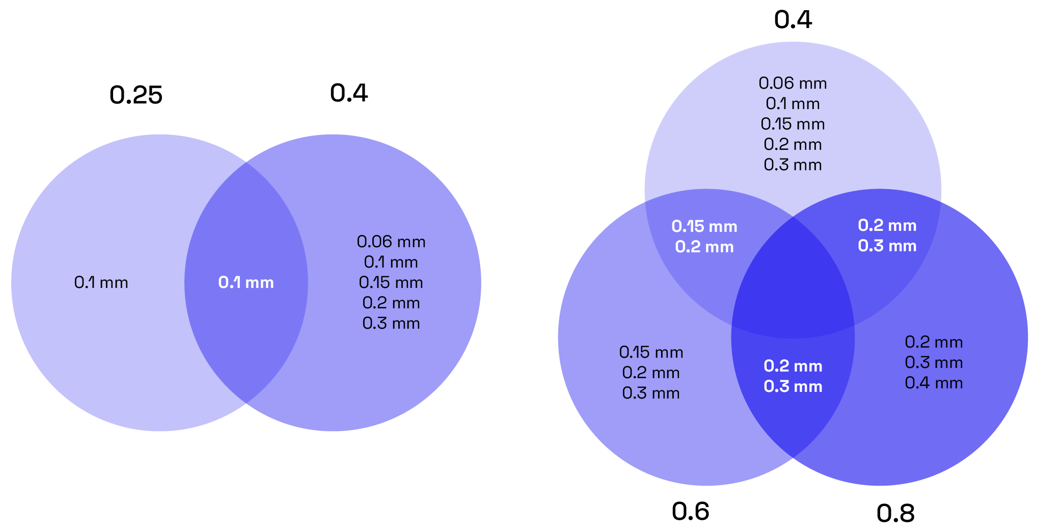

For dual extrusion prints, it is important that there are available overlapping profiles for the chosen print cores. When using two print cores with the same nozzle size (for example, 0.4 mm), this is not an issue. However, if two different nozzle sizes are used, both print cores must have profiles for the same layer height.
The AA 0.25 mm print core is only compatible with another AA 0.25 mm print core, or with the AA 0.4 print core when using 0.1 mm layer heights. Other print core sizes (0.4, 0.6, and 0.8 mm) have more overlap options. See the image below for an overview of compatible layer heights when combining different print core sizes:
Note: This is a general overview. Not all profiles may be available for all printer or print core types. For example, the CC 0.4 and AA+ 0.4 print cores only offer 0.15 mm and 0.2 mm profiles, while the CC+ 0.6 and HT 0.6 only have 0.2 mm profiles.
