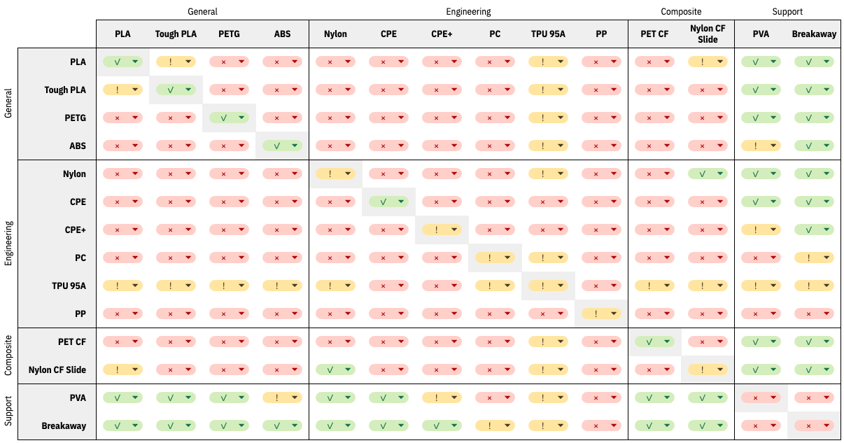

Dual material combinations
For an overview of possible dual-extrusion material combinations on S series printers, see the table below:
Tip: The icons in the table reflect the compatibility and support of the combination. Officially supported ( ✓ ), not supported ( × ), or experimental ( ! ).
Notes on dual-material combinations
  • The not supported combinations have either not been tested (not a logical combination) or are due to chemical incompatibility.
  • For the experimental combinations, the results depend on the model type. For more information on why a material combination is listed as experimental, visit the How to print guides of these materials.
  • UltiMaker PPS CF is excluded from this overview. Although this material supports some dual combinations, PPS CF is not compatible with the S series printers.
  • The material interlocking feature in UltiMaker Cura can greatly improve adhesion between non-similar materials, although results can vary per model.
  • For combinations with TPU95A, make sure to pre-dry TPU to limit oozing.
