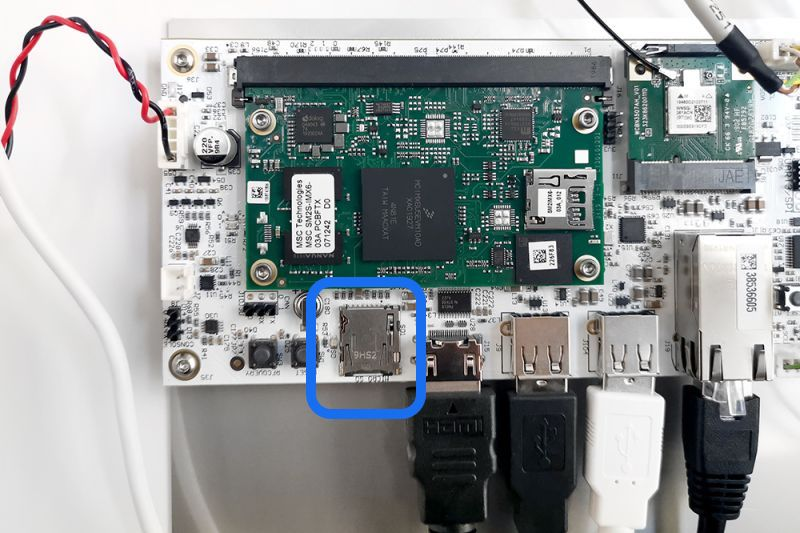

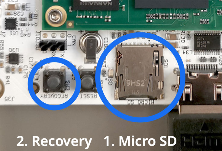

Insert SD card
Insert the Micro SD card into the slot at the side of the mainboard, near the green SOM board:
Recovery process
Recovery button
Press the small button marked 'Recovery', which is close to the SD card slot. Keep it pressed during the next steps.

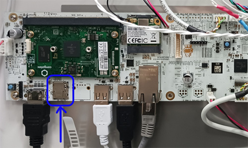

Insert SD card
