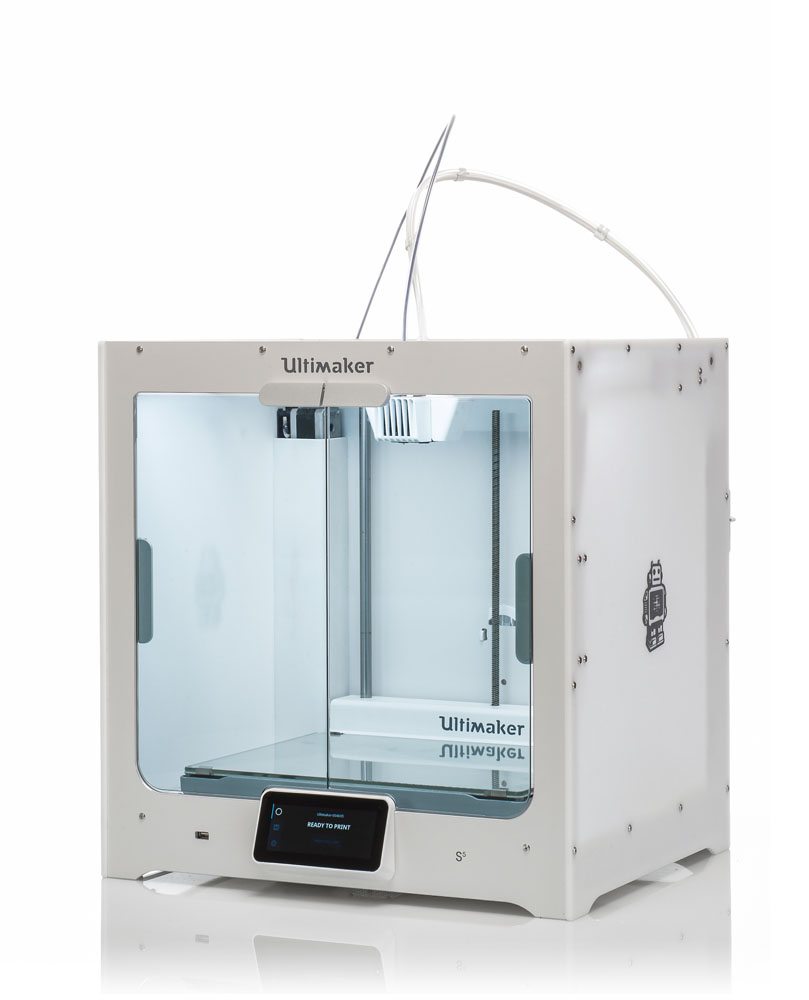

There are several ways to tell the two versions of the UltiMaker S5 apart. The simplest is by looking at the UltiMaker branding on the printer. In 2019, UltiMaker changed its branding, including a different logo. These changes are reflected in the newer version of the UltiMaker S5. The side panels of the UltiMaker S5R2 show the 'U' icon instead of the old UltiMaker mascot, the Ultibot.
The image on the left shows the 'U' icon on the side panels and the image on the right shows the Ultibot.

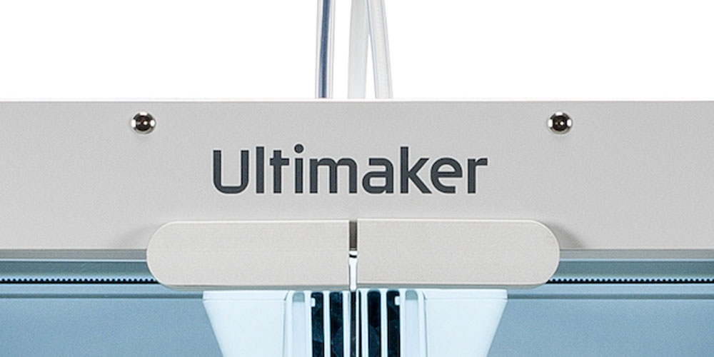

At the top of the front panel, the UltiMaker logo is displayed. The logo was also changed in the rebranding; you can see the difference in the images below.
The image on the left shows the 2019 update of the UltiMaker logo and the image on the right is the old logo.
