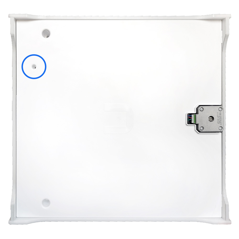

Next, perform the reset. This part of the process requires accessing the bottom of the printer to press the recovery button, so make sure you have sufficient space.
  1. Switch off the UltiMaker 2+ Connect.
  2. Gently place the machine on its left side.
  3. Insert the USB device containing the recovery file into the USB port at the front of the printer.
  4. Press the recovery button using the hex screwdriver (or alternative tool). See the image on the right.
  5. With the recovery button pressed, turn on the printer using the power switch at the back.
  6. Release the recovery button after about 2 seconds.
Note: The rest of this stage will be completed automatically by the UltiMaker 2+ Connect and no further interaction is required at this stage.
