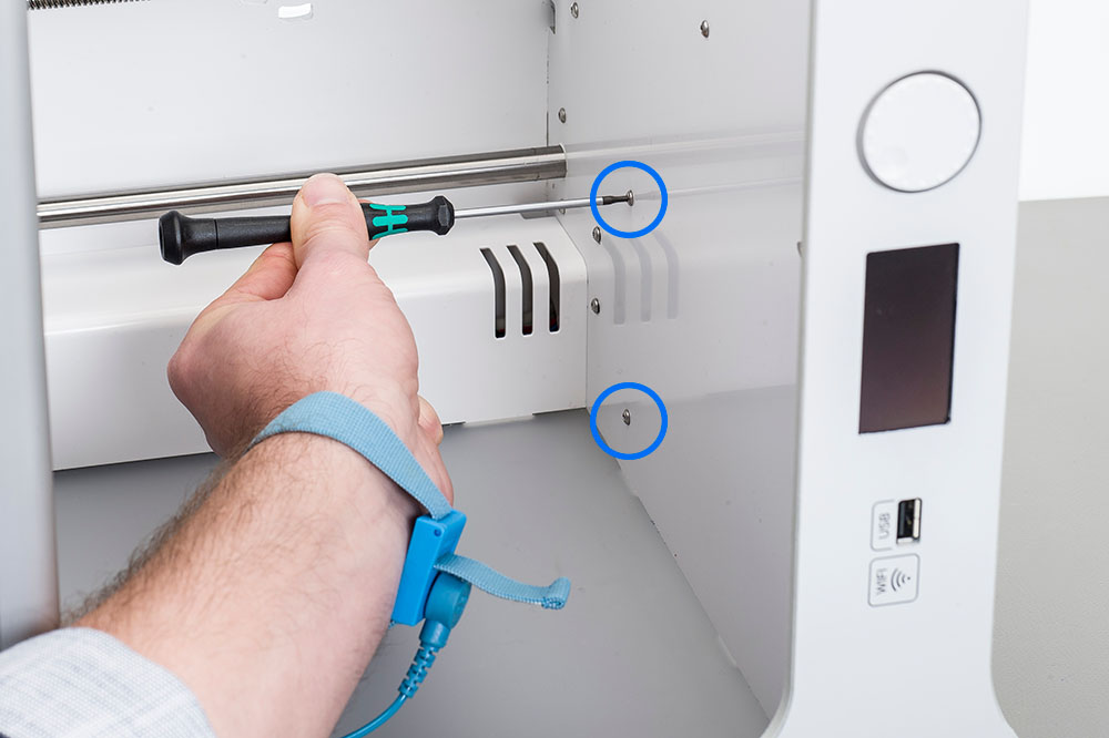

Gently place the printer on its left side. Manually move the Z stage upward. From the inside of the printer, use the hex screwdriver to remove the two bolts that secure the Olimex cover.

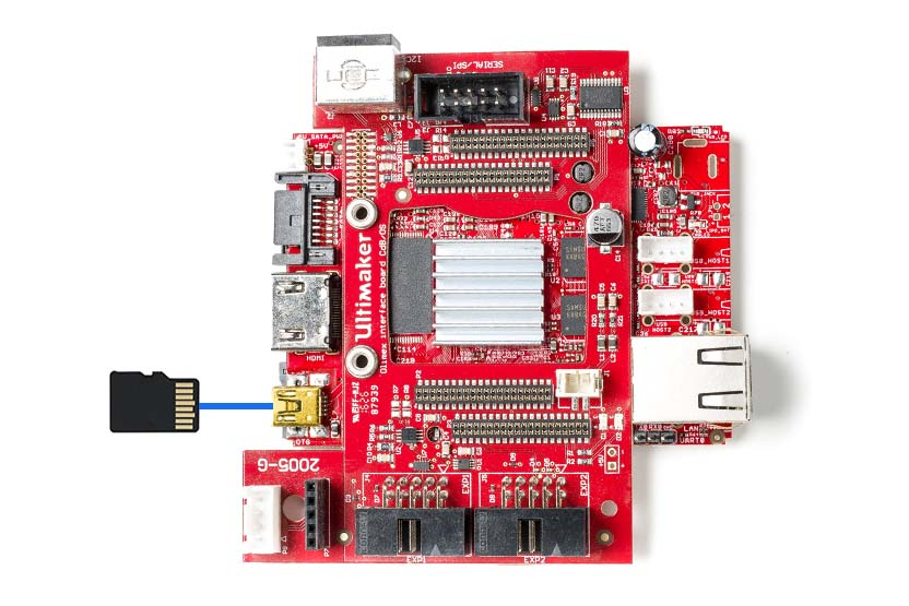

Insert card
Disconnect the USB cable from the Olimex board to reveal a slot for a micro SD card. Insert the card with the connecting pads facing towards you. Press it until you feel it click into place.

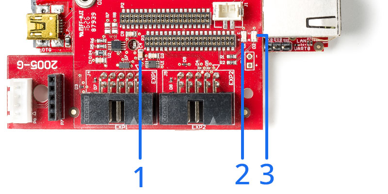

The recovery process will now start automatically. This will take approximately 2 minutes. The progress is indicated by three LEDs on the Olimex board. See the image and table below:
StepLED 1LED 2LED 3
Firmware installation in progressSlow blinkOnOn
Firmware installation completeOffOnSlow blink
Error while installing firmwareFast blinkFast blinkFast blink
If the recovery was successful, proceed to the next step. If the LEDs indicate that there was an error during the installation, please check if the recovery image was correctly stored to the SD card and try the process again.

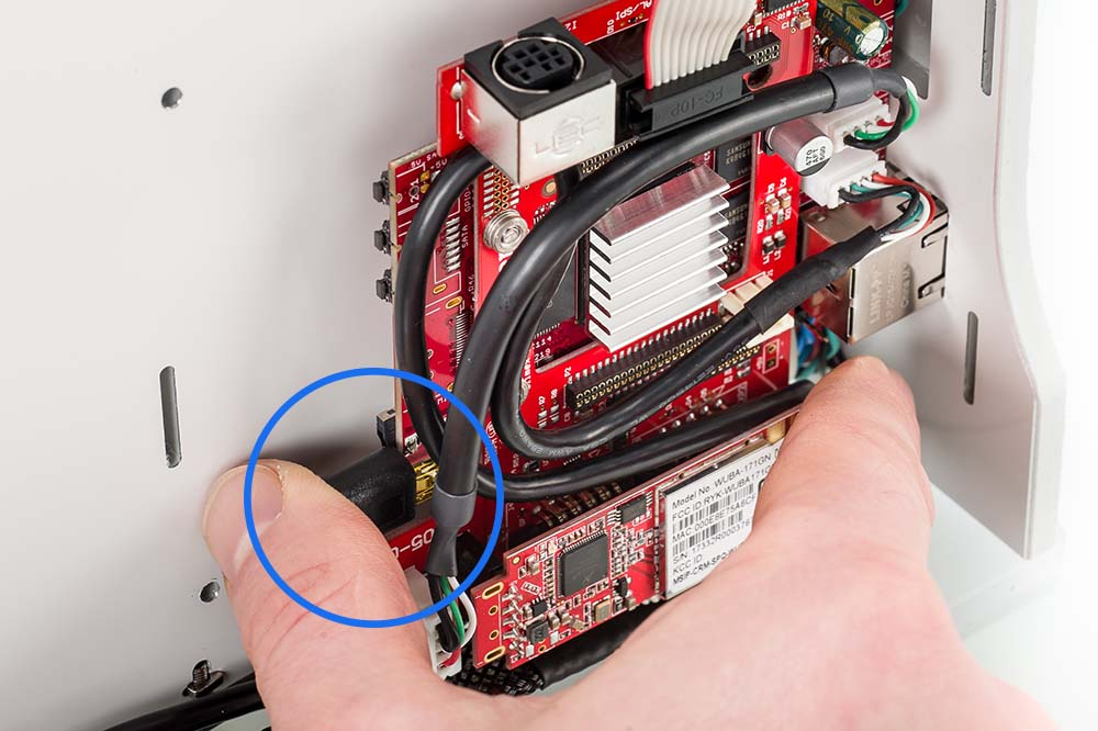

Eject SD cardRemove the SD card from the Olimex board by pressing it; it will click and eject. Next, reconnect the USB cable to the yellow-colored connector above the SD card slot.

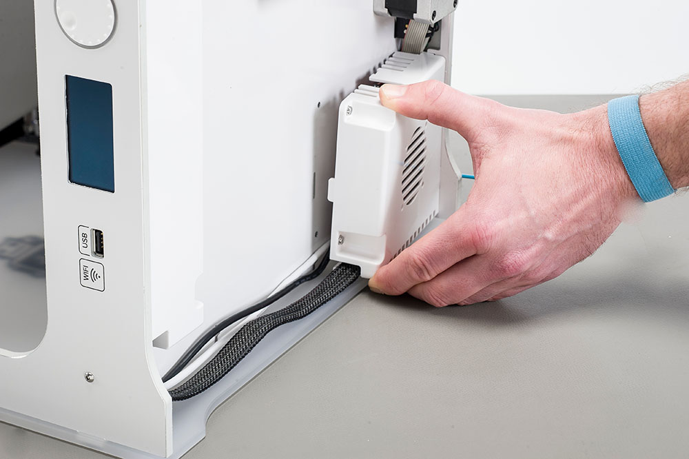

When the boot-up is successful, align the cover with the Olimex board and the slots in the panels. First insert the tabs of the cover into the back panel, then press it into the bottom panel. Ensure that the flatwires to the UltiController fit in the slot at the side and do not get stuck.
Secure the cover
Insert the two bolts from the inside of the printer and use the hex screwdriver to secure them. Ensure the hex nuts are still placed in the cover, and keep your finger on them when tightening the bolts.
