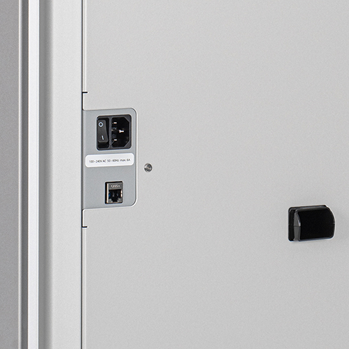

Power off the printer
Turn off the printer using the power switch at the back and disconnect the power cable.

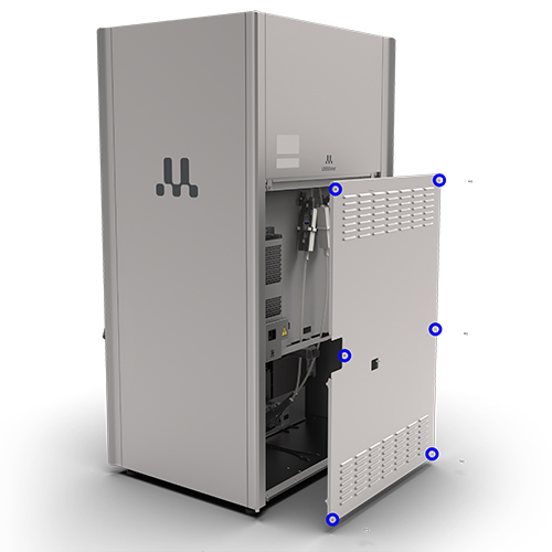

Remove the back cover panel
Use the Hex 2 screwdriver to remove the six M4×10 bolts that secure the back cover panel. Carefully move the panel away from the printer and place it aside.

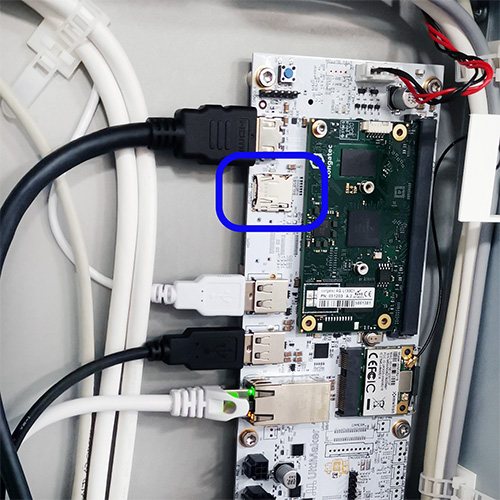

Insert the SD card
Insert the Micro SD card into the slot at the top left side of the mainboard (as seen from the back), underneath the HDMI cable.
