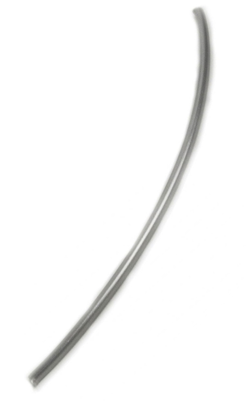

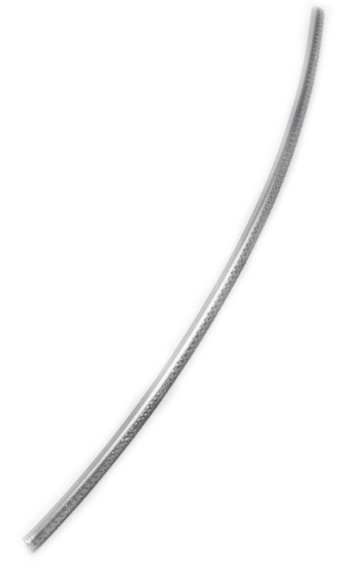

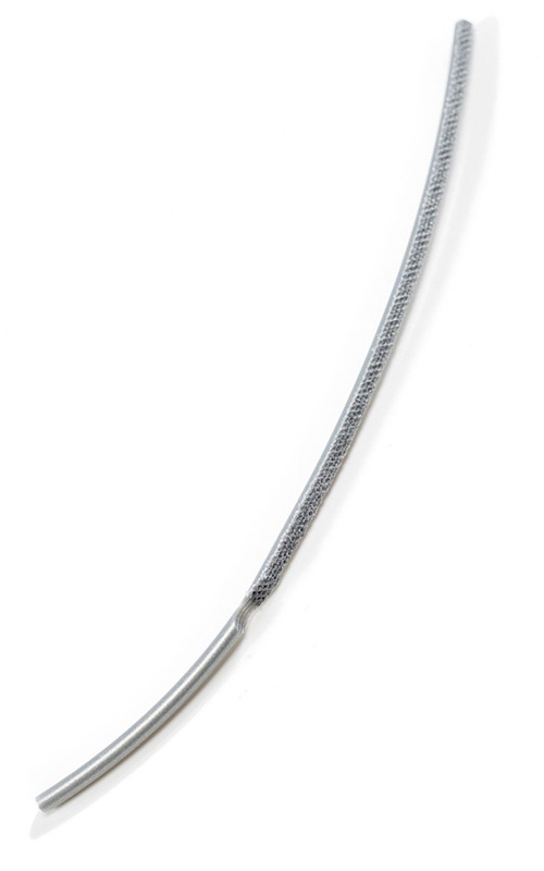

Setting the correct feeder tension is important for good-quality prints. If the tension is too low, the material can slip inside the feeder. If the tension is too high, the feeder can grind into the material and flatten it. If the feeder tension is set correctly, the filament should have clear and consistent marks after passing through the feeder. See the images below.
Good
Consistent marks on the filament indicate good feeder tension
Too low
No visible marks on the material indicate too low feeder tension
Too high
Flattened material or grinding indicates too high feeder tension
