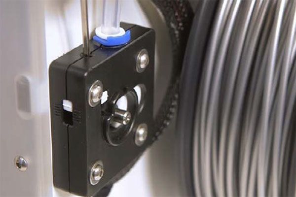

Tension
The tension of the feeder is controlled by a spring and lever inside the black feeder housing. In order to properly guide the filament through Bowden tube and into the print head, the feeder tension must be set correctly. You can check the feeder tension by the white indicator at the front and side of the feeder.
Tension too high
(indicator toward the bottom)
If the feeder tension is too high, the filament will be pressed against the knurled wheel too hard. This can flatten the filament. In worse scenarios, the feeder will dig (grind) into the material.
Eventually, this will lead to the filament getting stuck in the feeder and lower or no extrusion.
Tension too low
(indicator toward the top)
When the feeder tension is too low, the feeder does not have sufficient grip on the filament. The filament can slip inside the feeder instead of forwarding consistently through the Bowden tube.
This will show as under-extrusion in your prints.
For Ultimaker PLA, the feeder tension should be on the loosest setting. This means the white tension indicator at the side of the feeder should be all the way at the top. For other (third-party) materials, the feeder tension may have to be adjusted.
Insert a 2 mm hex key or screwdriver into the hole at the top of the feeder. Turn the screw to adjust the feeder tension. The lower the white tension indicator at the side is, the more tension is on the feeder.
