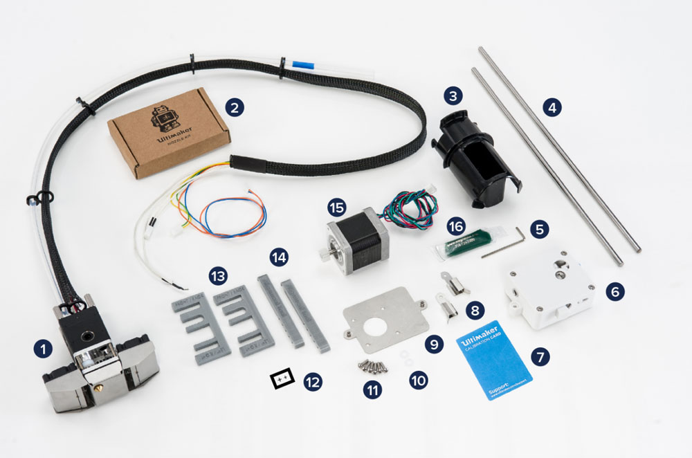

What's in the box
Your upgrade kit consists of several parts. Check if all the parts are included before continuing.
  1. Pre-assembled print head
  2. Nozzle kit
  3. Short spool holder
  4. Print head shafts (X and Y)
  5. Hex wrench 2 mm
  6. Pre-assembled feeder
  1. Calibration card
  2. Build plate clamps (2x)
  3. Geared feeder mounting plate
  4. M3 ring (2x)
  5. M3x10 mm bolts (6x)
  6. "+" stickers
  1. Print head (dis)assemble tools (2x)
  2. Print head alignment tools (2x)
  3. Feeder motor
  4. Grease
Tip: The STL files for the printed tools are also available at the bottom of this page.
