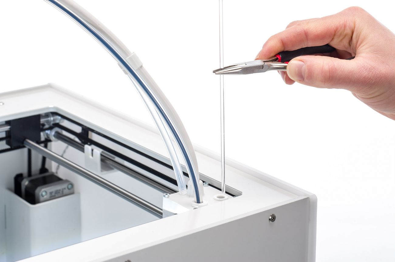

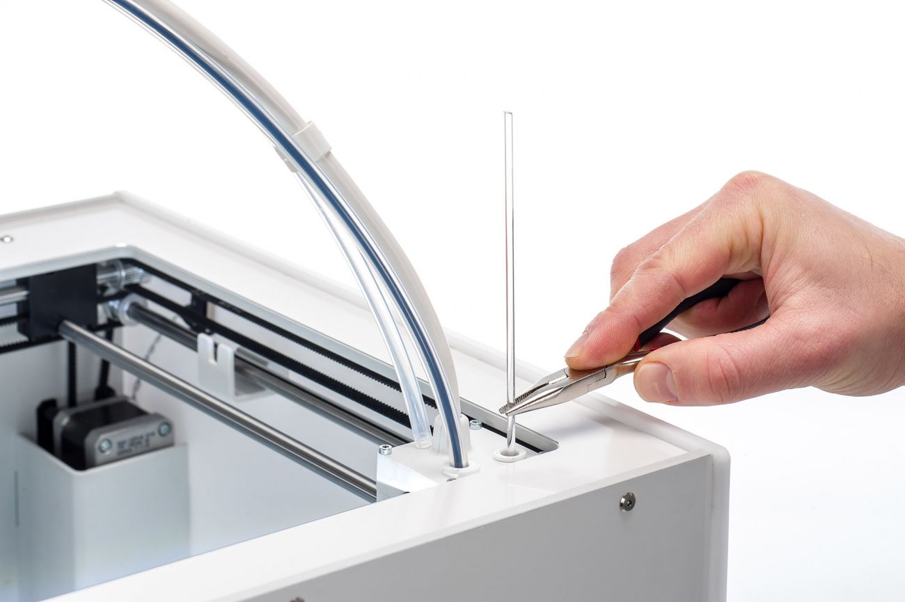

Removing broken material
If the material cannot be unloaded properly to perform all of these maintenance actions, or if you see the material is broken, the filament must be removed manually. It is possible that the material is stuck in a position that is hard to recover from.
Please read this guide for instructions on how to remove the material and proceed with the maintenance actions: How to clean the system if you can't unload material from the feeder
