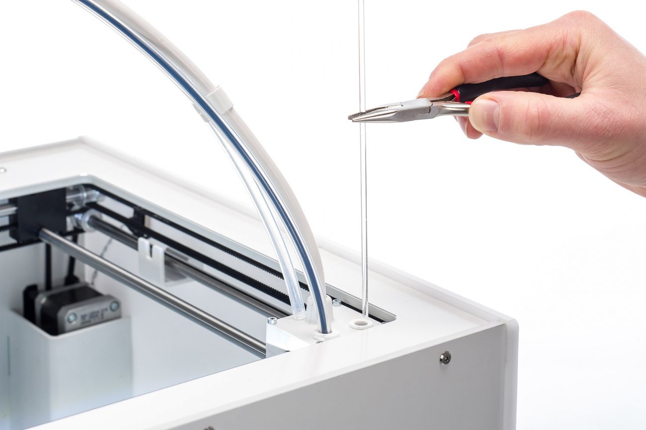

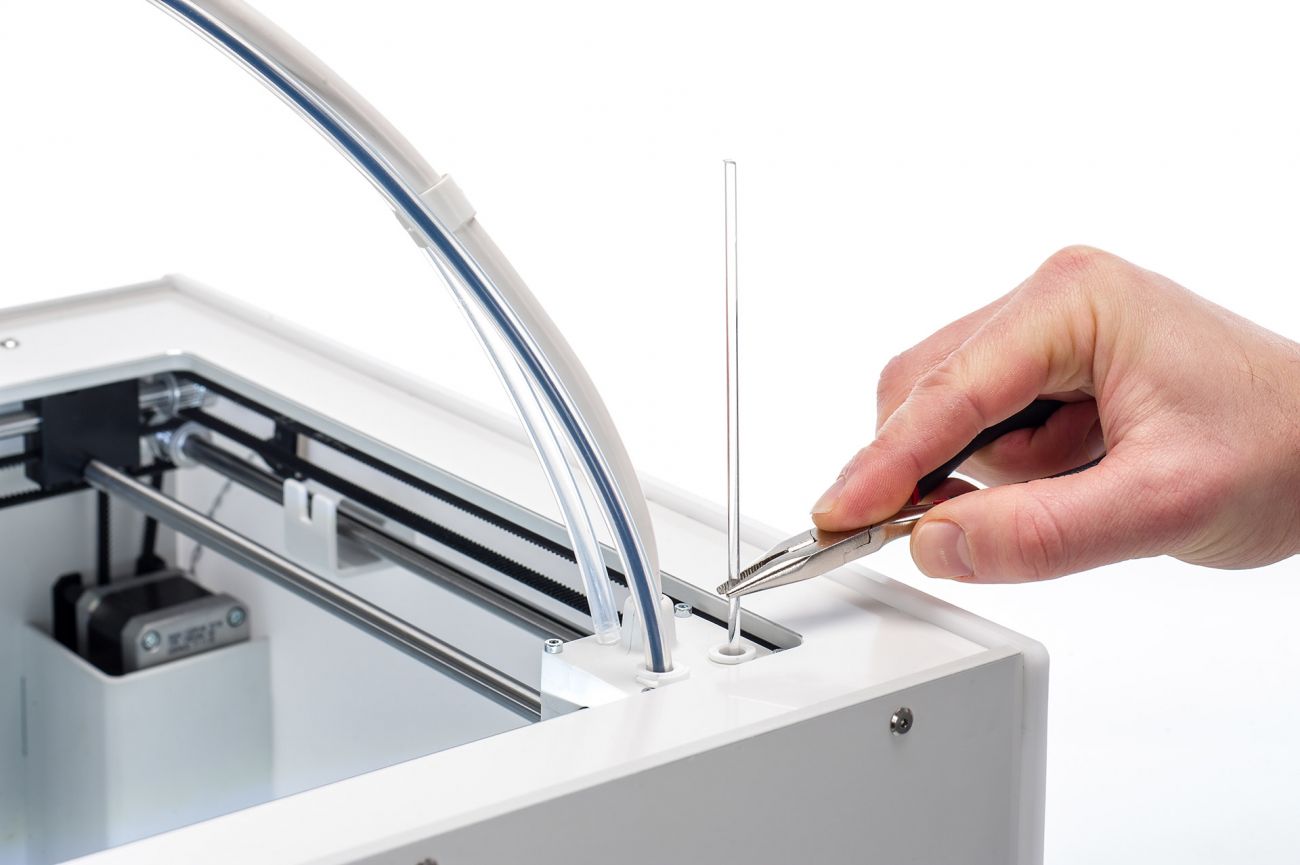

Cleaning the print core can be done quickly and easily with the 'hot and cold pull' method. It is recommended to use UltiMaker cleaning filament, as this is the most effective material for cleaning the print cores.
In the menu on the display of the printer, open the Preferences menu (gear icon), then select Maintenance → Print head → Print core cleaning. Follow the instructions on the display, or visit this page for more information: How to perform a hot and cold pull.
Caution: It is never recommended to insert a needle into the nozzle tip to help unclog the print core. Especially do not use a needle on the print core CC Red 0.6. If the point of the needle touches the ruby, this can irreparably damage it.
