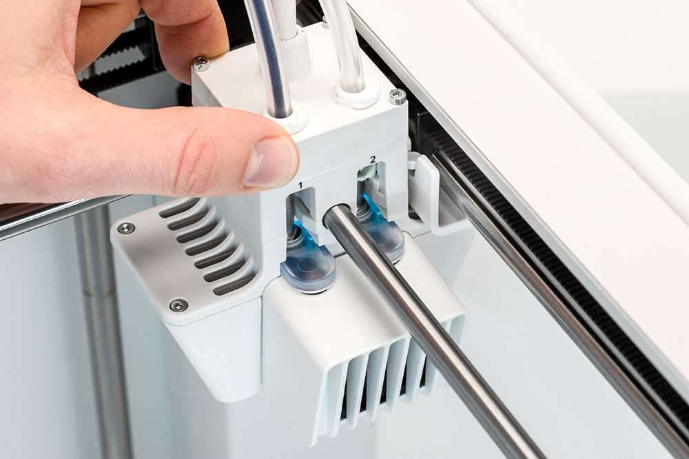

Before restarting active leveling, heat up the print cores and clean the outside of the nozzles. You can find printer-specific instructions here: UltiMaker 3, S series, Factor 4.

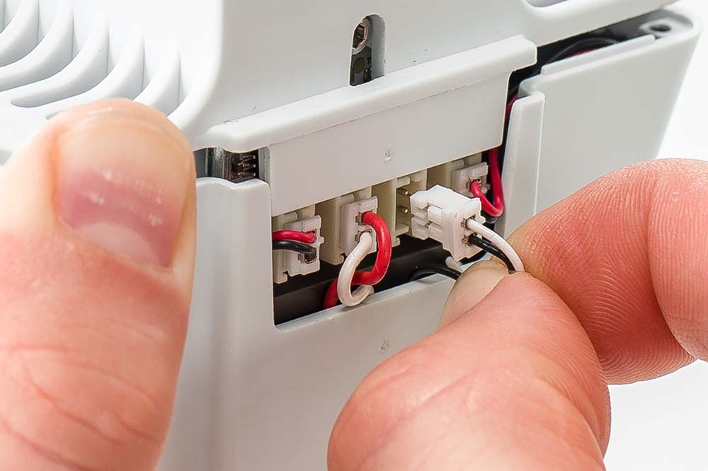

2. Check the capacitive sensor wires and connector
Note: This section applies to the UltiMaker 3, S3, and S5. Other S series printers use an inductive sensor with a flexible copper flatwire. Instead, check if this flatwire is still connected to the PCB at the back of the print head. On the Factor 4, check if the cable at the back is not damaged.

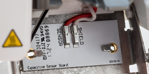

The capacitive sensor board which enables active leveling is located in the front fan bracket of the print head. This is connected with a red (sensor) and white (shield) wire. Check if both of these wires are still properly connected. If they have come loose or show signs of damage, the capacitive sensor wires must be reconnected or replaced. Contact support for further assistance.
See the following pictures for reference:
OK: Both wires are securely connected to the board and no damage is visible.

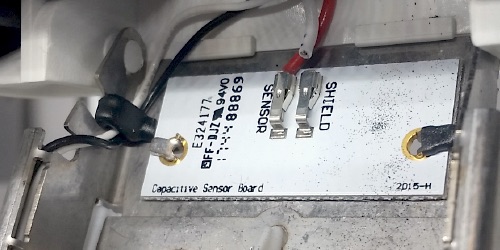

Not OK: One of the wires is broken and disconnected from the board.

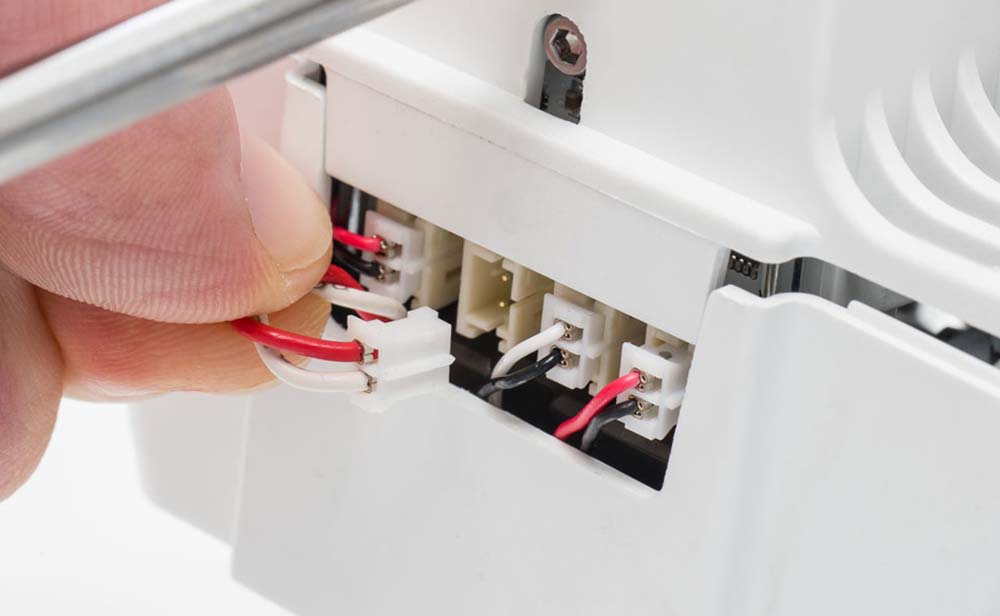

Also check the connection of the wires to the print head PCB. This connector is visible at the back of the print head. The capacitive sensor wires are the second connector from the left, as seen from the back:

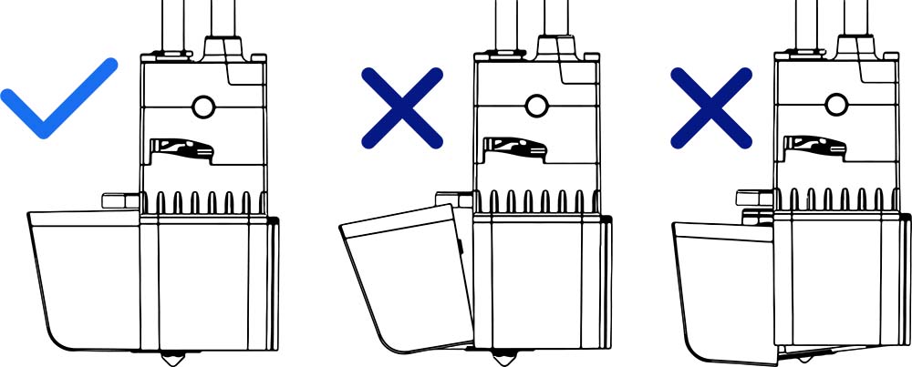

Make sure that the fan bracket closes properly and the bottom of the print head is completely flat. If the fan bracket, which contains the capacitive or inductive sensor board, is at an angle to the build plate, the readings will not be accurate.
If it is tilting forward, something may be preventing the bracket from closing completely. This could be due to material on the print core's heater block, an incorrectly placed nozzle cover, or an incorrectly placed fan. When it's tilting backward, the metal of the fan bracket could be bent. In these cases, it is recommended to contact support for further assistance.

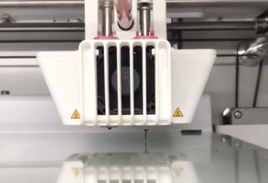

  • A video of the active leveling behavior
