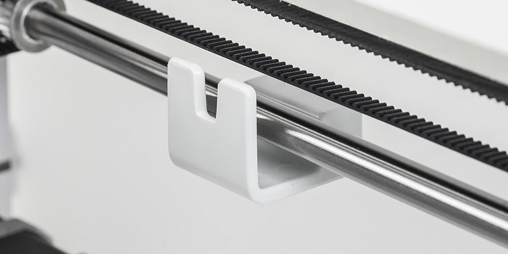

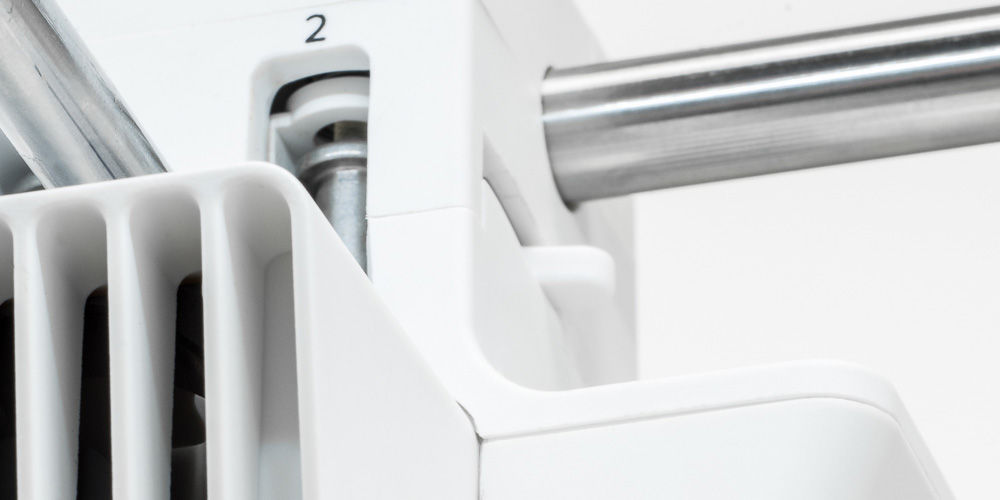

The switch bay enables the second print core to be lifted and lowered. The switch bay (left) is the white bracket on the right side of the frame, which changes the position of the lift switch (right) in the print head.
It is important that the print core switching functions well for active leveling and a correct nozzle alignment in dual-extrusion prints. The lift switch is already calibrated at the factory, but calibration can also be performed manually if needed.

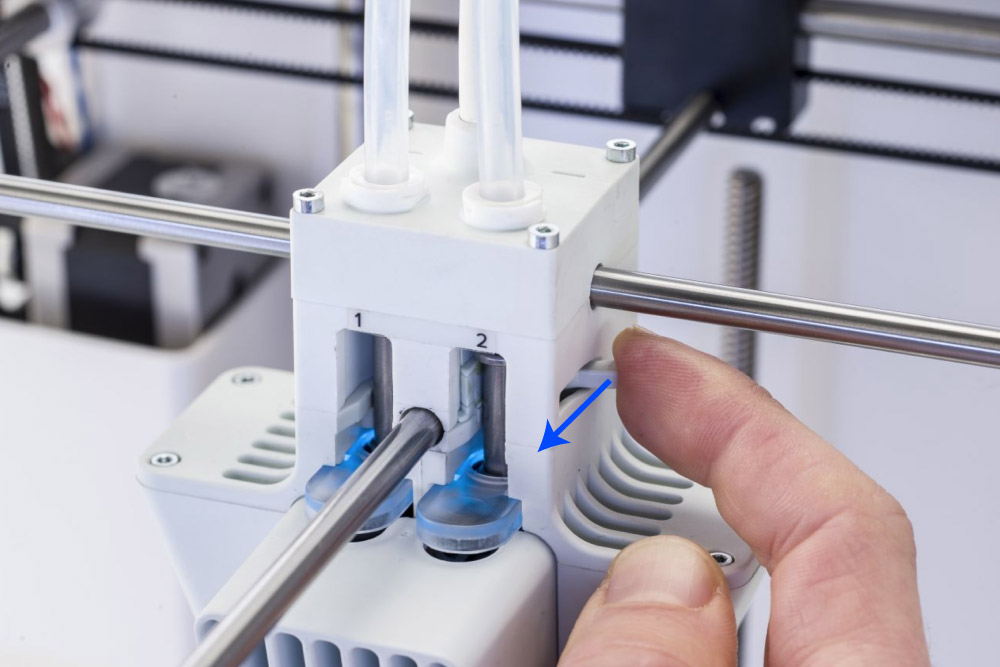

  2. Use your finger to move the lift switch on the side of the print head to point towards you.

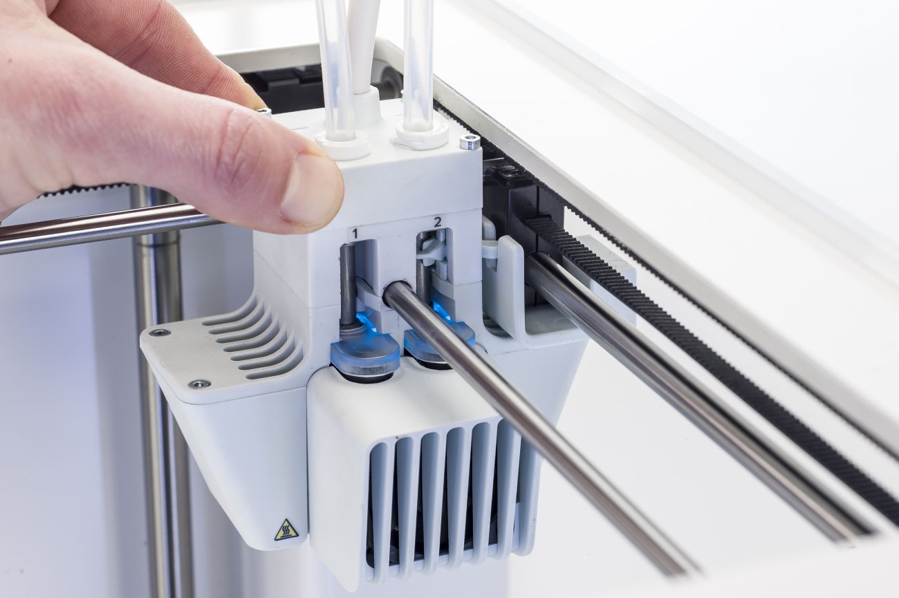

  3. Move the print head by hand so that the lift switch fits in the switching bay.

Lift_Switch_1.jpgLift_Switch_2.jfif
Manually move the lift switch to the frontPlace the print head in the switch bay
Note: If the lift switch is properly activated, but you do not observe that the second print core is lifted and lowered, there could be a problem with the lift switch mechanism inside the print head. Visit this page for additional information.
