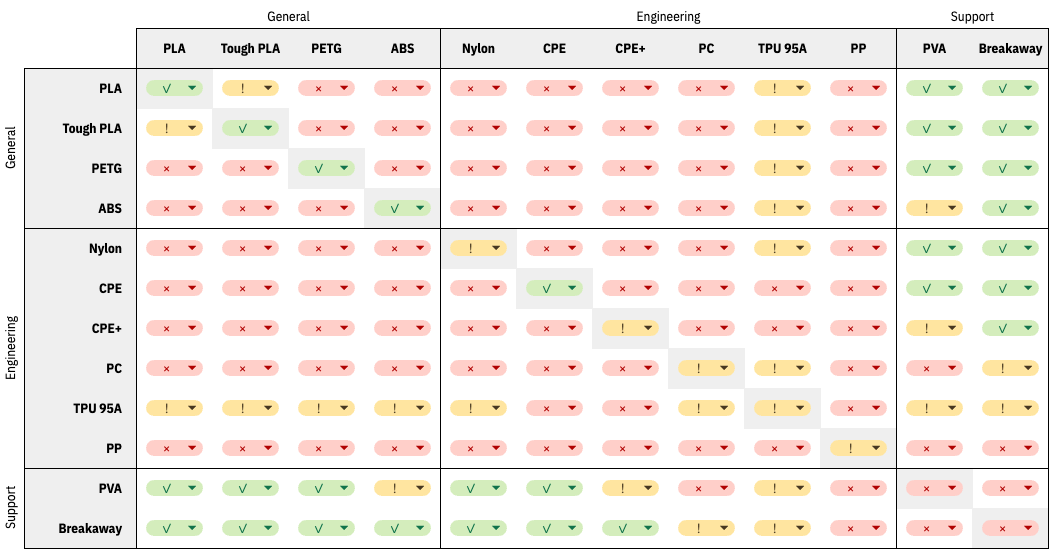

Dual material compatibility
For an overview of possible dual-extrusion material combinations, take a look at the table below:
Tip: The icons in the table reflect the compatibility and support of the combination. Officially supported ( ✓ ), not supported ( × ), or experimental ( ! ). Results are dependent on the model type that is used. For more information on why a material combination is listed as experimental, visit the How to print guides of these materials.
Note: The composite materials (PET CF, Nylon CF Slide, and PPS CF) are excluded from this overview. Although these materials support dual combinations with other materials, they are not compatible with the UltiMaker 3 and 3 Extended.
