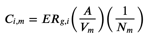

The estimated exposure concentration for chemical i, (μg m-3), for a particular room model m, was calculated using the following equation:
Where Screenshot_2022-07-25_at_13.22.17.png is the emission rate of a compound, in this case Formaldehyde, (ERformaldehyde= 1162 μg h-1) 1 when printing Ultrafuse® 17-4PH or Ultrafuse® 316L together with Ultrafuse® Support layer, A is the number of printers in the modelled room. Vm and Nm are the volume and air exchange rate of the modelled room.
According to the German AgBB LCI and the ECHA (EU) public DNEL for inhalation, the TLV for formaldehyde is 100 µg/m³. Here are some examples of work environment preparations to set up a safe and compliance printing environment.

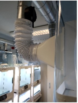

Alternatively, users can ensure a high and confined air exchange by connecting the Air Manager to their Central Exhaust System (CES) via an adaptor, see below.
Option - Extraction system setup
In some cases, the available room volume and/ or Air Exchange Rate (AER; general ventilation) are insufficient to ensure relevant Threshold Limit Values (TLV) of VOCS or UFPs are not exceeded. This is especially true when the room volume and/or AER are too small or low relative to the number of printers or other emitters in the room. For a very small or poorly ventilated room even one printer can cause exceedance of TLVs, or Lowest Concentration of Concern associated with standards like UL2904 or AgBB. In these cases, customers may choose to connect the Air Manager to their Central Exhaust System (CES) or Local Extraction System (LES).
The Air Manager is equipped with an opening at the back with four holes that allows to install an adaptor which, in turn, can engage with a given exhaust system interface (i.e., the suction hose). Exhaust systems also come with different architectures and capabilities; the user shall assess the health-related hazards and benchmark among different solutions to come up with the optimal filtration system. Therefore, Ultimaker recommends users to adapt and supply the adaptor upon consultation of the responsible EHS manager at users’ facility.Extraction1.jpg
Caution: when emissions from printers via the Air Manager are extracted to a CES or LES, it must be ensured that these emissions do not end-up unfiltered in the same, or other working areas. Exhaust to outside air is recommended if the CES or LES is not fitted with an adequate filter. Especially VOCs need to be filtered; UFPs are largely removed by the Air Manager Filter already.

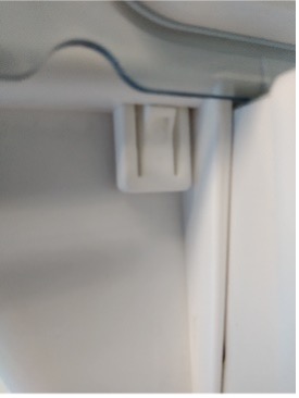

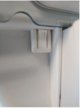

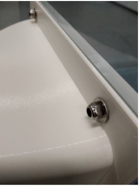

Remove the Air Manager hood form the printer by pushing the clips on each side of the Air Manager balcony
Step 2:

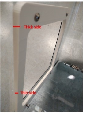

  • Place the Bumper inside of the hood and maintain it with the screws (head of the screw inside the hood)
Note: Picture shows the hood in an upside-down position
  • the opening of the Bumper MUST be facing inside the hood (it will cover the shape of the filter box)
  • The Bumper MUST be with the thicker side facing the bottom of the hood and the thin side facing the top of the hood (towards the sealing)
Step 3:

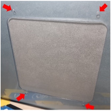

  • Place the Adaptor at the outside of the hood, making sure that all screws are placed into the holes.
  • Place the nuts and tighten them together with the screws using the Allen key and the pliers or any nut holder tool.
  • Tighten it until the adaptor and the bumper are fixed to the hood and cannot move freely anymore.
  • The use of washers is possible but not mandatory
Step 4:
  • Place the Air Manager back on the top of the printer, by sliding the clips inside the intended holes
  • You will hear two clicking sounds (one on each side)
  • The hood is then well installed, and the bumper will take the outer shape of the filter box when closing the hood.
  • Connect the adaptor to the central exhaust system
