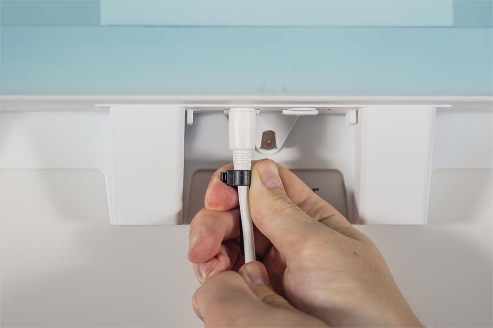

Check the cables
First, always ensure that the cable is connected securely to the bottom of the Air Manager. Firmly insert the cable, and place the stress relief clip around it. Fully slide it upwards for the most secure connection.
Tip: The strain relief will prevent the cable from getting pulled out of the Air Manager by accident.

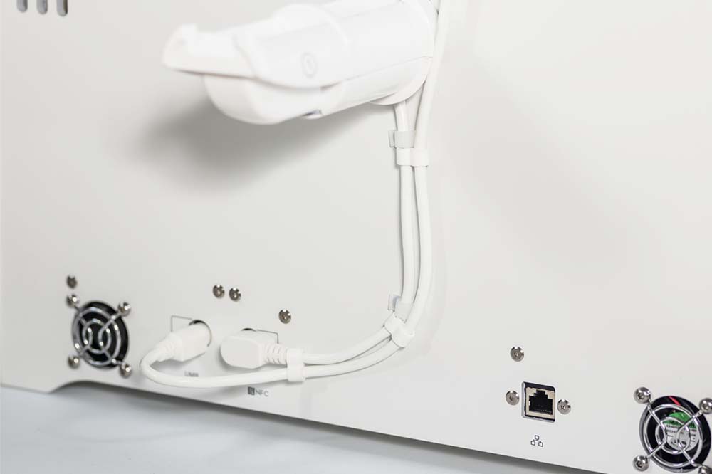

Printer with Air Manager (no Material Station)
If the Air Manager is connected directly to the S Series printer, check that the UMB cable going into the UMB OUT port of the printer is securely connected. The Air Manager must not be plugged into the NFC port at the back of the printer.

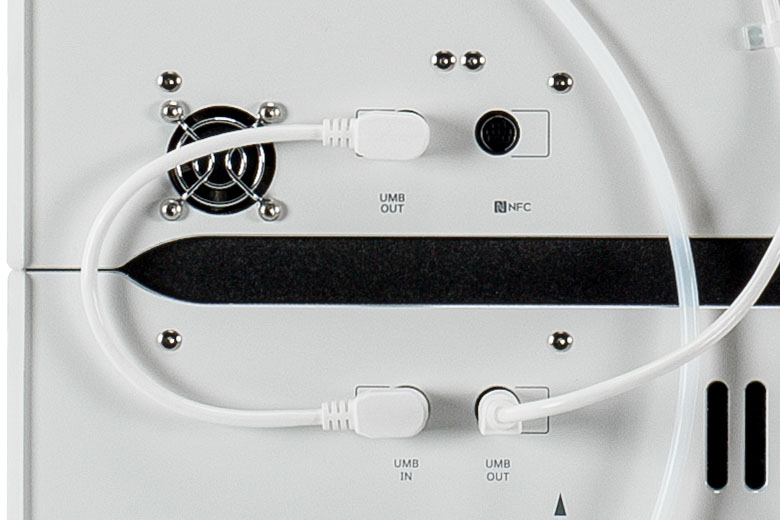

S Series Pro Bundle (with Material Station)
If you have a Pro Bundle, the Air Manager connects to the UMB OUT port of the Material Station. Check that this cable is securely connected. Also make sure that the Material Station cable is properly connected to the printer.
Connections for an S Series printer with Air Manager and using the spool holder.Connections for a Pro Bundle setup.
Note: If the printer is used in combination with a Material Station (Pro Bundle), the Air Manager cable must not be secured to the Bowden tubes that run between the decouplers and the feeders of the printer. These tubes move during operation of the Pro Bundle. This can cause the Air Manager cable to come loose over time and lead to an unexpected ER80 error message. Additionally, the restriction of the Bowden tubes' movements could cause errors during loading or unloading of material.
