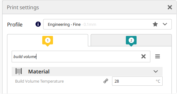

Build volume temperature
The Air Manager maintains the internal temperature of the printer at the desired Build Volume Temperature. The Build Volume Temperature is a setting within UltiMaker Cura.
Tip: Use the search function to quickly find the build volume temperature setting. For the best results, always use the latest version of UltiMaker Cura.
The Air Manager adjusts the fan speed to maintain the specified chamber temperature. The fan speed is calculated depending on the build plate temperature as well as the ambient temperature, measured by the Air Manager's own temperature sensor.
Note: When slicing using a very old version of Ultimaker Cura, or any other slicer which does not have a value for the build volume temperature, the Air Manager will default to 100% fan speed.
Note: The build volume temperature has a maximum value of 50 °C to prevent damage to the printer.
