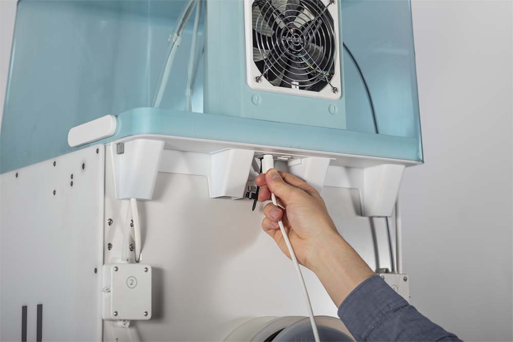

  2. Disconnect the Air Manager cable from the Air Manager and from the UMB OUT port on the back of the printer or the Material Station.

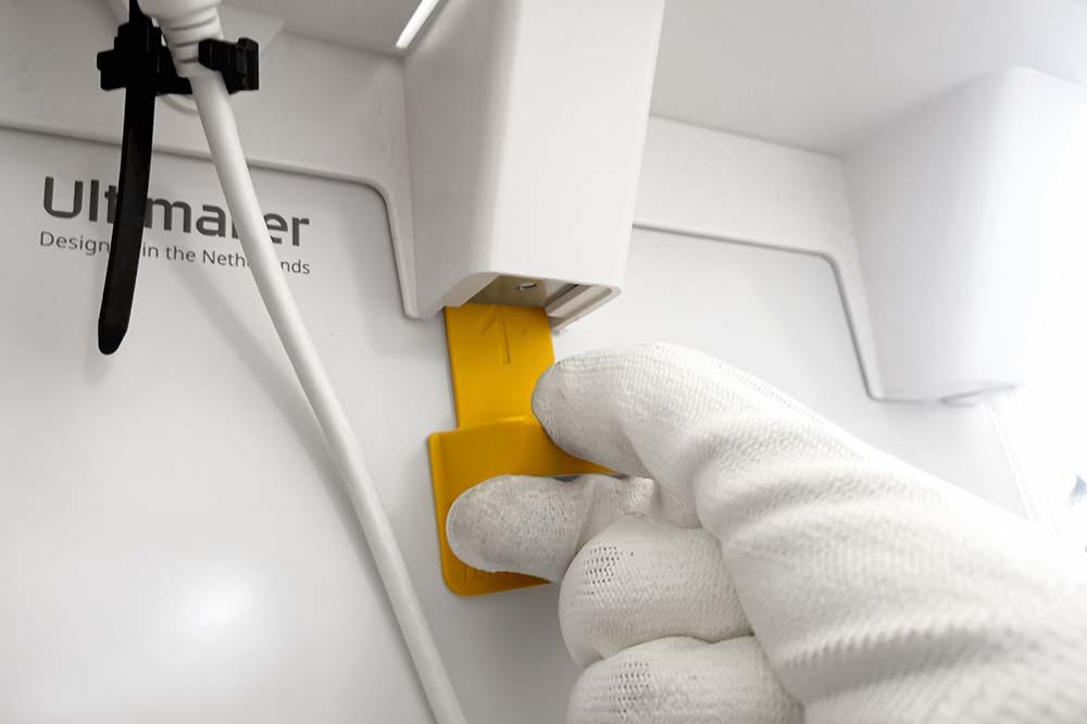

  3. Take the two removal tools and align them with the leaf springs in the mounting bracket.
  4. Insert the removal tools behind the leaf springs.
  5. Push upwards until you hear a click.
  6. Gently lift the entire Air Manager off the printer.
