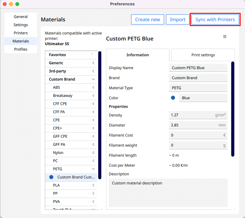

1. Start synchronization process

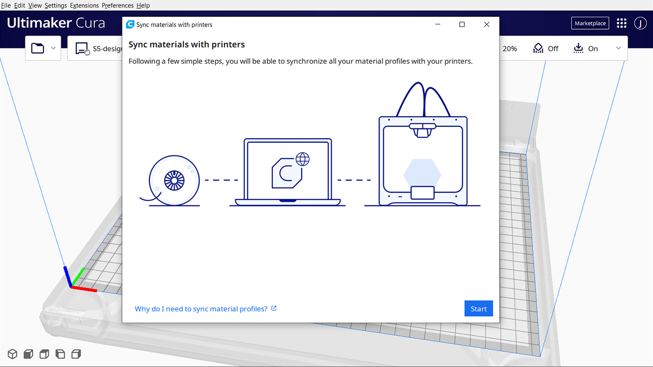

Open the Cura Preferences menu and select the Materials tab. In the top-right corner, select Sync with Printers. This will load the sync wizard; click Start to begin.

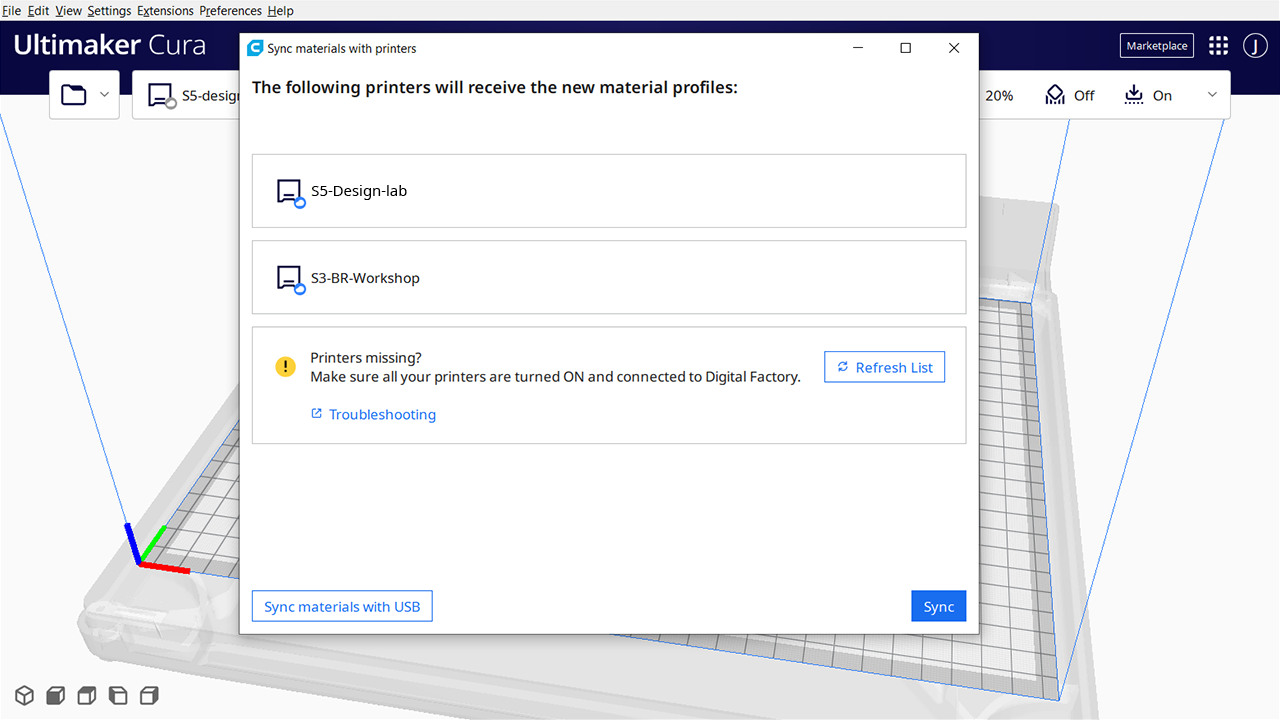

2. Printer overview
In the next screen, you will see an overview of all printers that will receive the new material profiles. Only printers that are currently turned on and connected to the Digital Factory can receive the profiles.

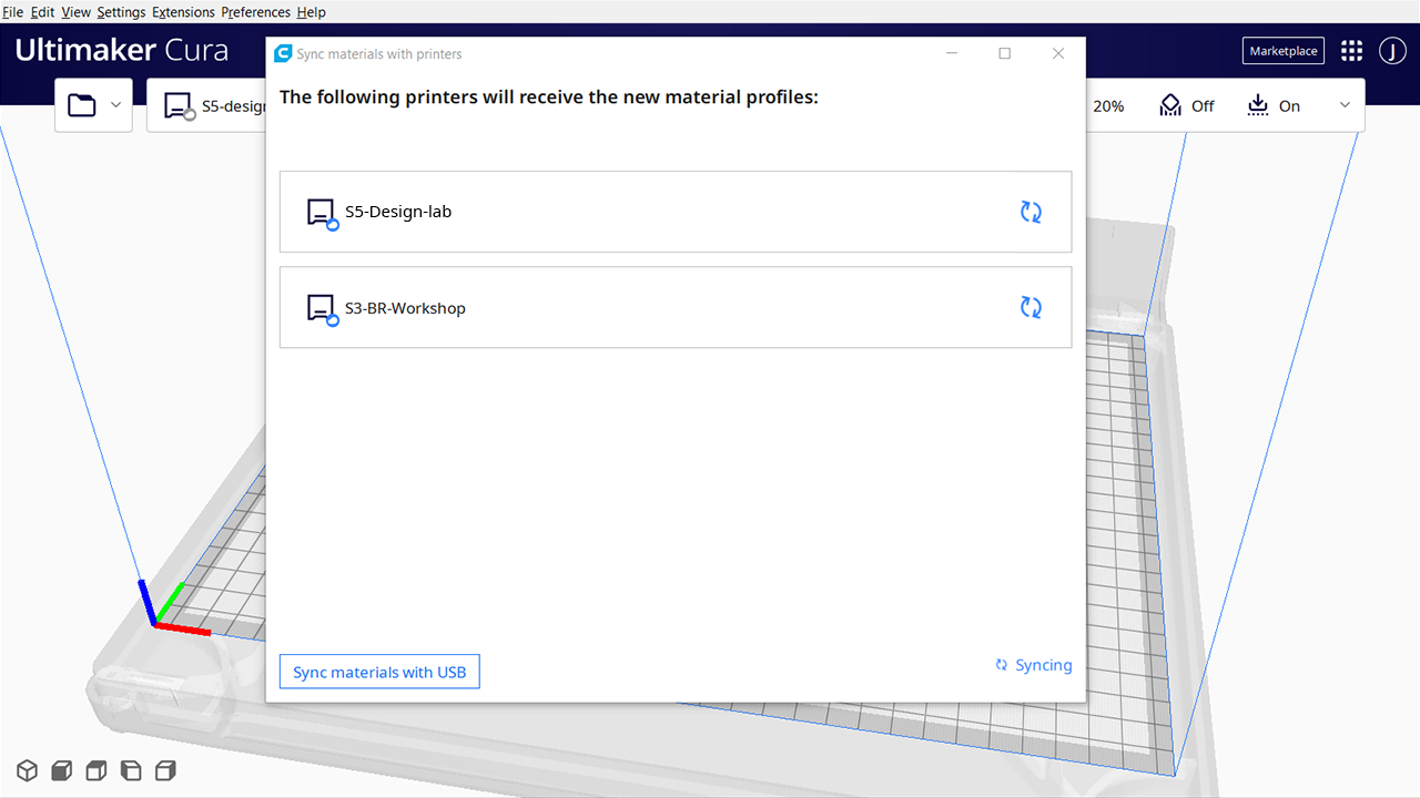

3. Synchronization
Press Sync in the bottom-right corner to start the synchronization process. Wait for the process to complete.

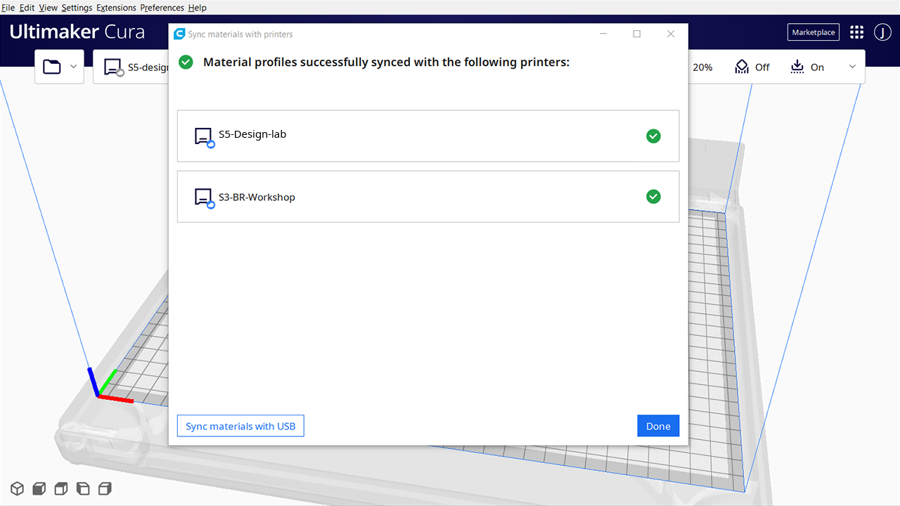

4. Finish
When the syncing is finished, click the Done button to exit the synchronization screen.

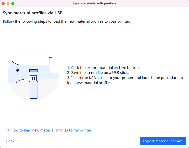

3. Export material archive
The next screen provides instructions. Click the Export material archive button and save the file (materials.umm) to the root directory of a USB drive.
