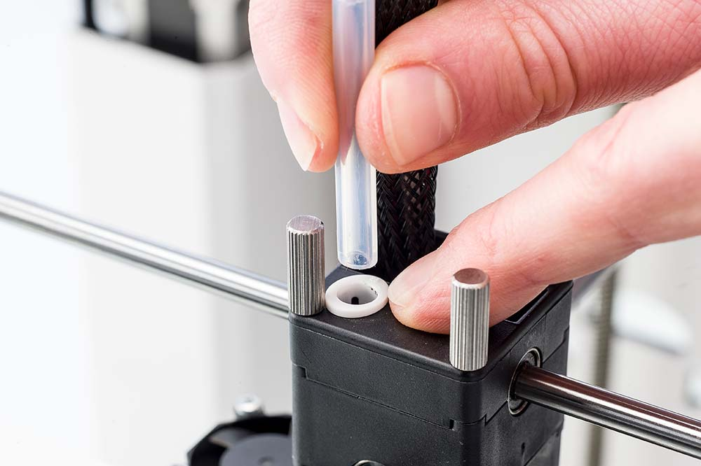

3. Remove Bowden tubeRemove the clamp clip from the print head. Push down on the white tube coupling collet and pull the Bowden tube up and out of the print head.

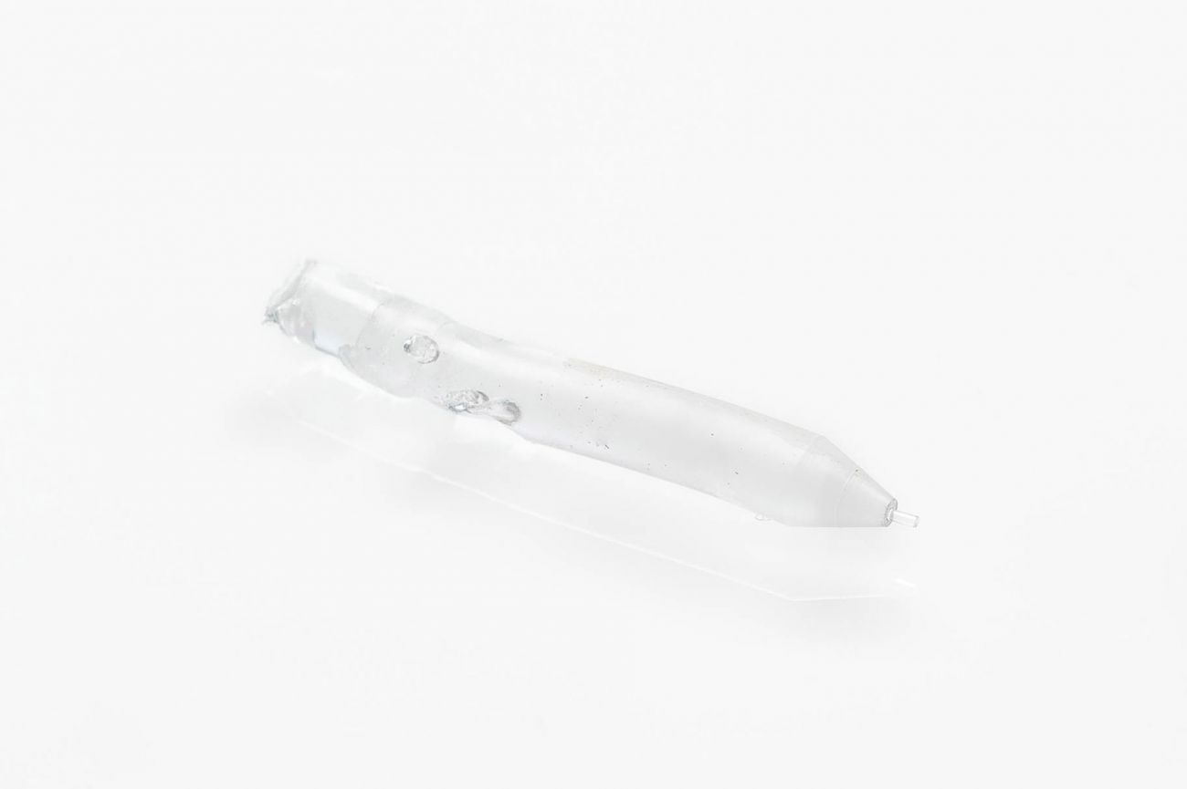

6. InspectCheck the tip of the filament. It should come out clean and cone-shaped (like the inside of the nozzle). If it is not clean, raise the temperature again and repeat steps 3 - 6.

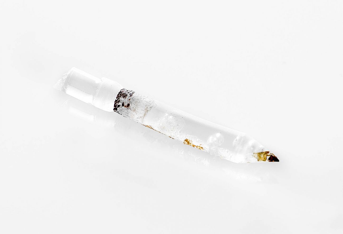

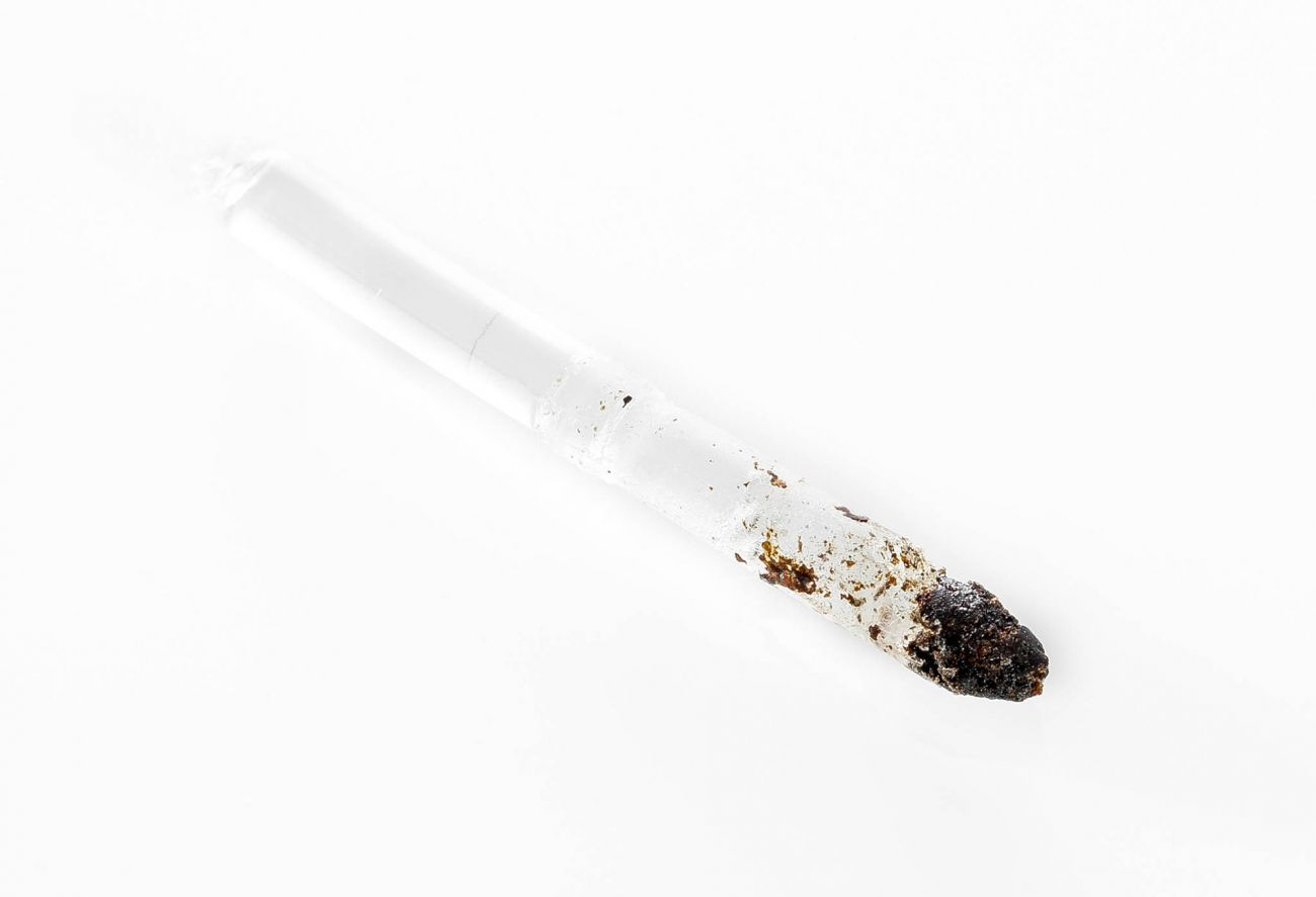

Too much carbonized material, repeat the cleaning processAlmost clean, perform one more cold pullThe tip of the filament is completely clean, proceed to reassembly

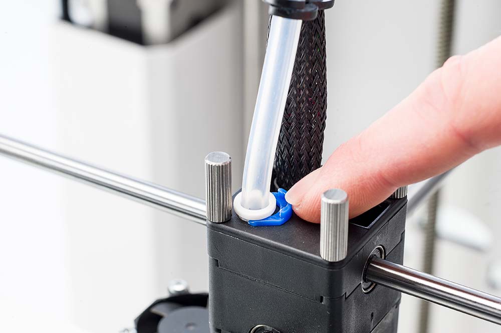

1. Insert Bowden tubePush the Bowden tube back into the print head. Make sure it is fully inserted. Secure it with the clamp clip.
