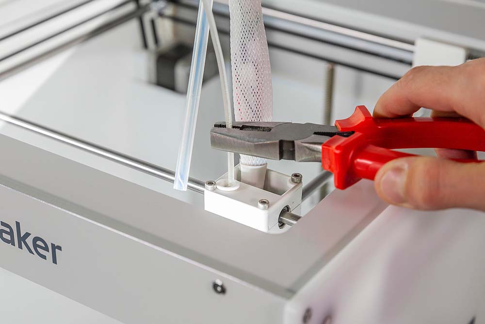

1. Insert materialWhen the nozzle has reached its target temperature, insert the piece of filament into the print head. It is recommended to hold the filament with pliers.
2. Apply pressureApply some pressure to the filament for ±1 second so that it extrudes from the nozzle or until it cannot be pushed any further.

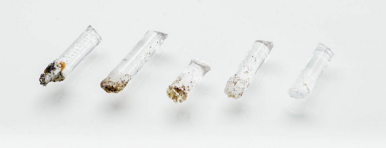

4. Cut and repeatCut off the tip of the filament that you have just pulled out. Repeat these steps several times until the tip comes out fairly clean. See the examples below.
Above. Hot pull results. Repeat the steps until the filament comes out clean.
Left. Apply pressure to the filament using pliers.

5. Cut and repeatInspect the tip of the filament. If there is still carbonized material visible, cut off the tip, raise the nozzle temperature, and repeat the cold pull. When the filament has a clean, cone-shaped tip like on the left in the image below, the nozzle was successfully cleaned.
