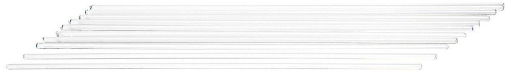

UltiMaker cleaning filament is a pack of precut, straightened pieces of material. They are ideal for cleaning the inside of the print cores and removing any blockages. It is the most effective material for the hot and cold pull procedure.
What is cleaning filament
Cleaning filament are sticks of 2.85 mm material. These sticks are straight for easy insertion into the print head during the hot and cold pull procedure. They are precut to an optimized length. One stick of cleaning filament is easy to handle and is sufficient to clean one severely blocked print core, or even multiple cores with minor blockages.
UltiMaker cleaning filament is transparent polycarbonate (PC) material. If you need to learn more about the material specifications, please take a look at the UltiMaker PC safety data sheet.

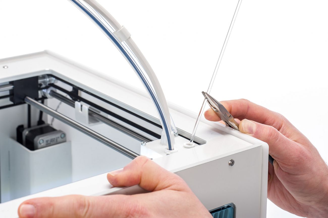

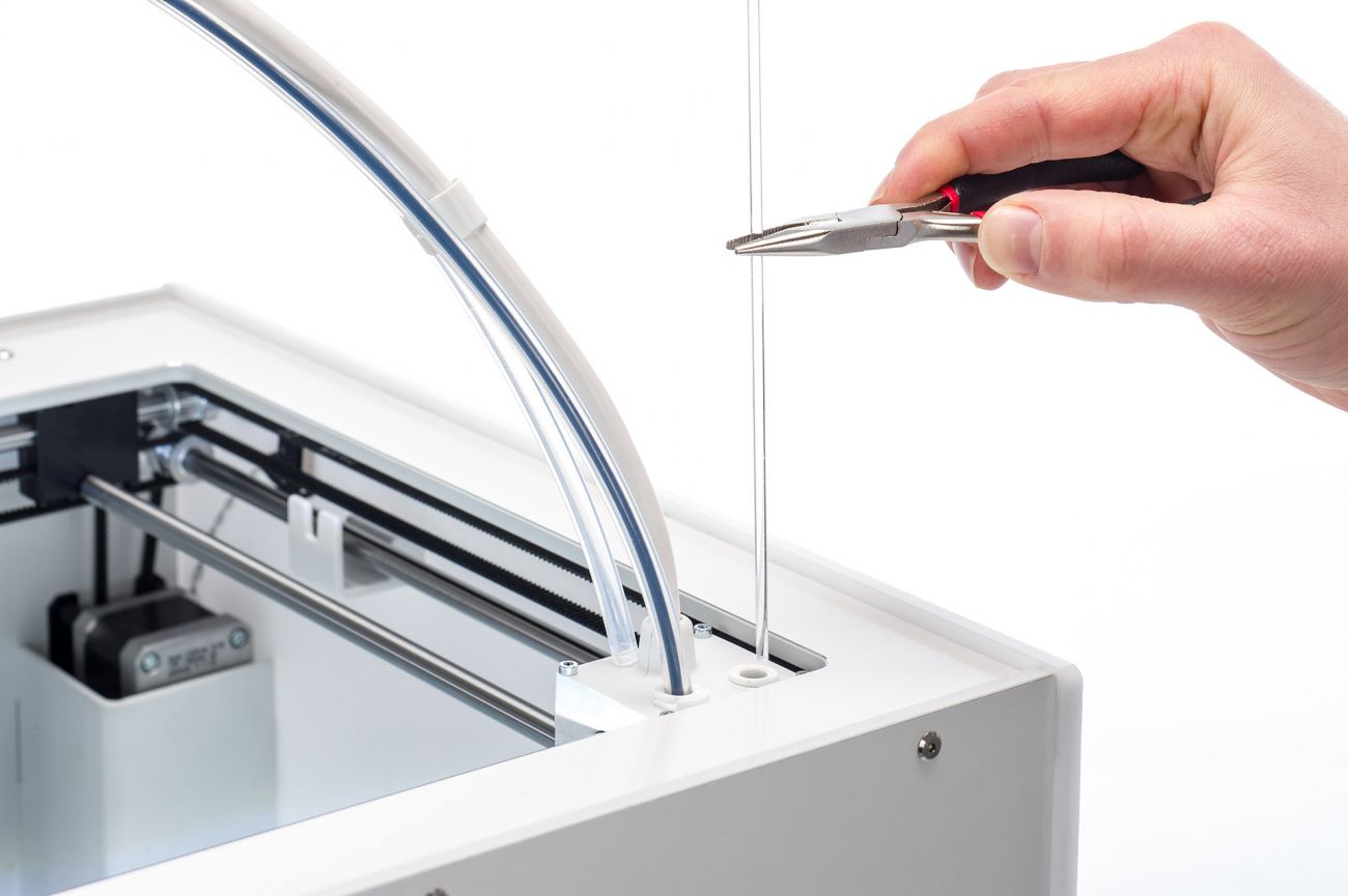

This filament can be used to clean the print cores of the UltiMaker 3, Factor 4, and S series printers by applying hot and cold pulls. Hot pulls are used to get the biggest parts of carbonized material out of the print core and are highly recommended when the print core is clogged. With a cold pull, the remaining small particles will be removed, ensuring the print core is completely clean.
The UltiMaker 3, Factor 4, and S series printers contain a guided process for cleaning the print cores. You will need a stick of cleaning filament, pliers, and cutting pliers / wire cutters. Detailed instructions on how to perform the hot and cold pull procedure with UltiMaker cleaning filament can be found on this page:
