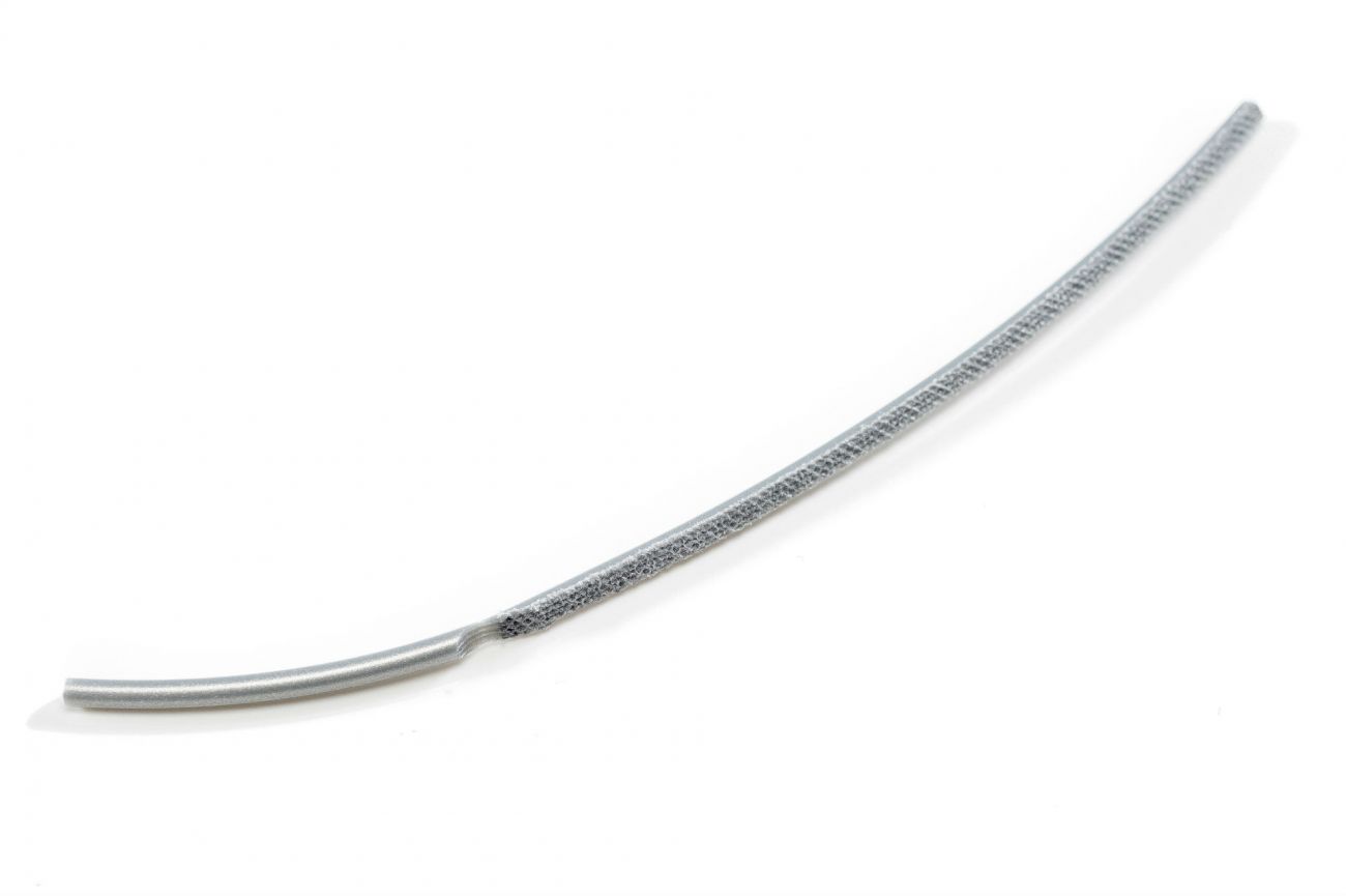

If there is still material left on the spool but it will not unload, it is likely that there was a problem with material grinding. Grinding of the material usually occurs either because of a blockage in the hot end, or when the material is stuck on the spool.
Removing the material is usually quite simple. During the unload material procedure, gently pull the filament below the feeder. Once the ground part has passed the feeder's knurled wheel, it will properly unload.

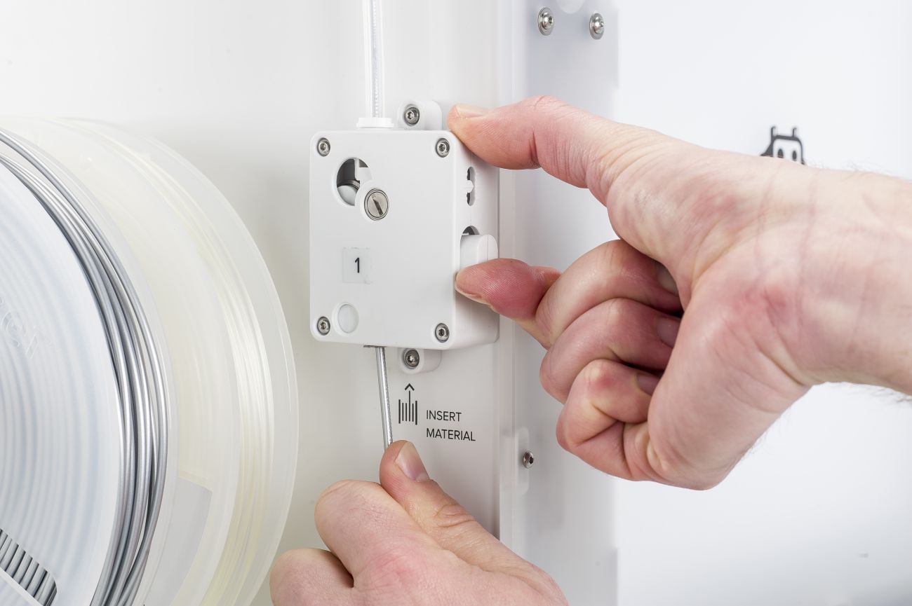

Alternatively, relieve the tension of the knurled wheel by lifting up the feeder lever. On the Ultimaker S3 and Ultimaker S5, flip the lever upwards completely. On the Ultimaker 2+ and Ultimaker 3, firmly push the lever upwards. Then, manually pull out the material.
Grinding.jpegUM3-Remove-stuck-material.jfif
An example of material grindingRelieving the feeder tension

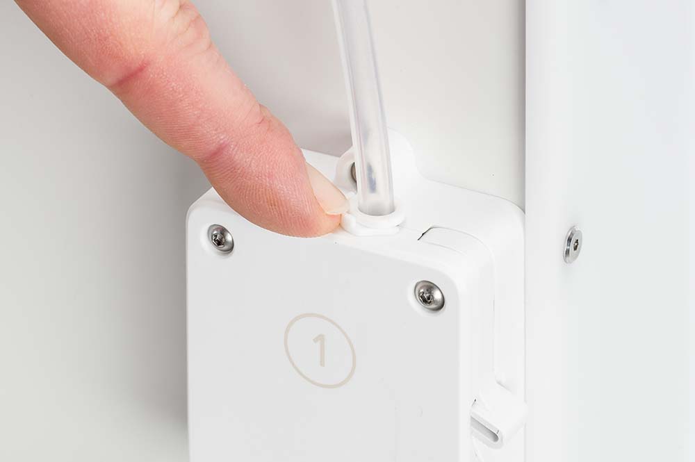

At the back of the printer, remove the clamp clip from around the tube coupling collet in the feeder.

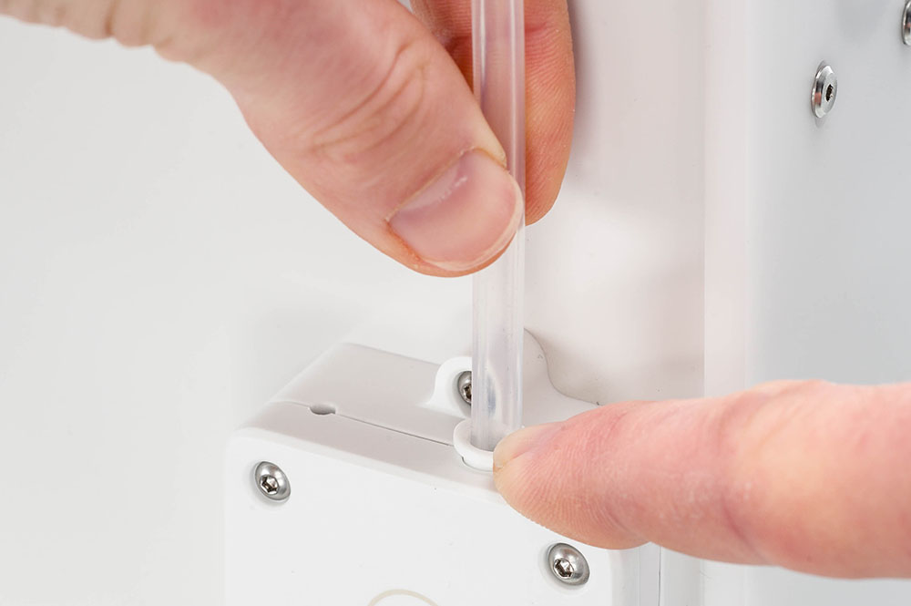

Press down on the tube coupling collet and pull the Bowden tube out of the feeder. If the Bowden tube cannot be removed from the feeder easily, lift up the lever at the side to release the pressure and try pulling out the Bowden tube again.
