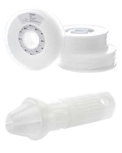

PP (polypropylene) is a commonly used polymer in the industry. Properties of UltiMaker PP include exceptional layer bonding and relatively good adhesion to the build plate, especially when using adhesion sheets.
UltiMaker PP is available in a 'natural' color.

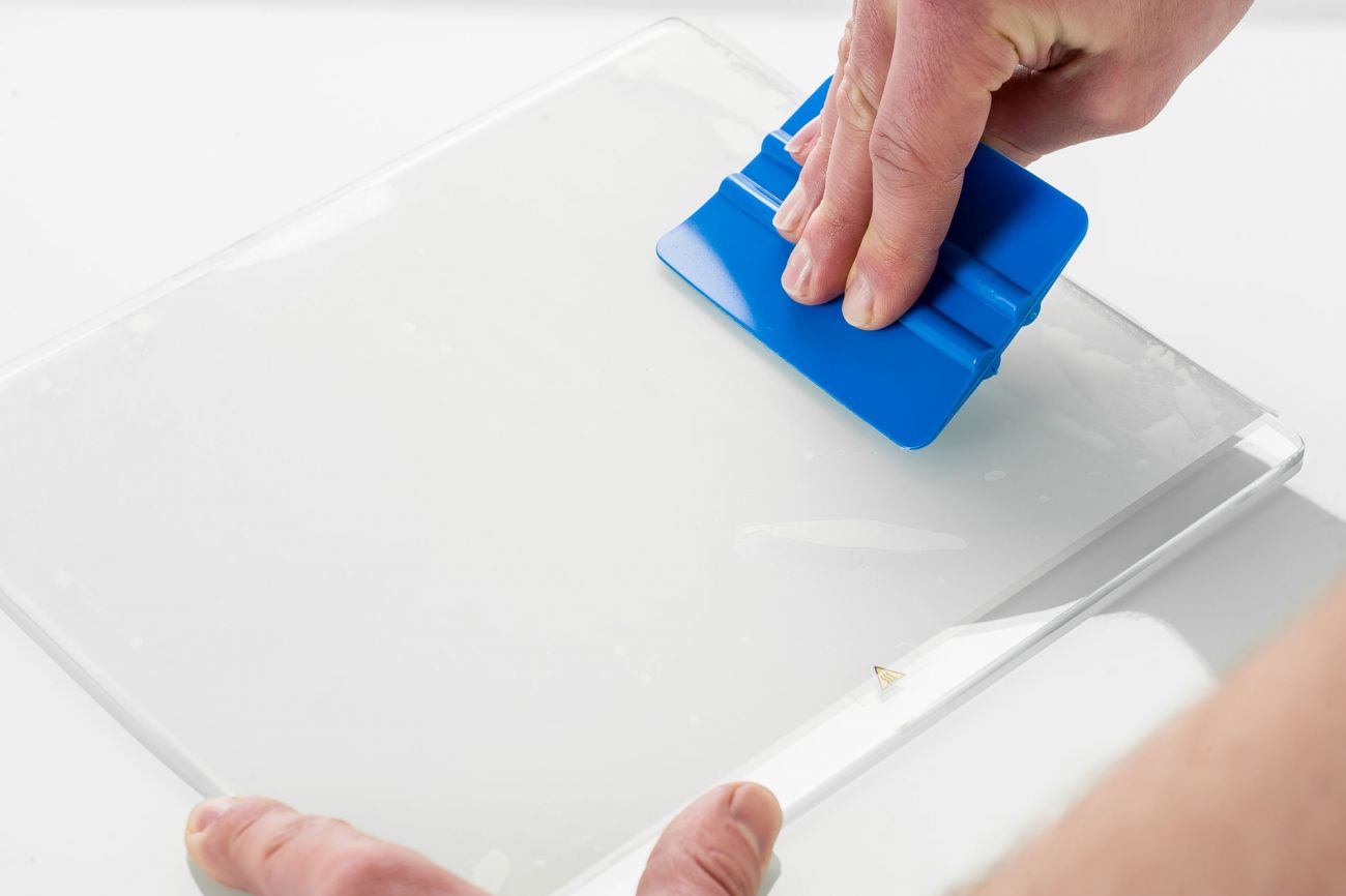

UltiMaker PP is prone to warping. Therefore, the use of an adhesion sheet is strongly recommended when printing with UltiMaker PP on a glass build plate. This ensures optimal adhesion to the build plate. Adhesion sheets are available in two sizes and are also included in the Advanced 3D Printing Kits for the Ultimaker 2+ and Ultimaker 3.

How_to_print_with_UltimakerPP_Adhesive_sheets_applied_to_the_build_plate.jpgMagigoo-PP.jpg
Caution: The addition of an adhesion sheet or glue is recommended on the glass plate to improve adhesion and thereby prevent the chance of print failure and printer damage. Additionally, the use of an additional adhesive can prevent over-adhesion to the glass plate, which could otherwise damage or break the plate.
