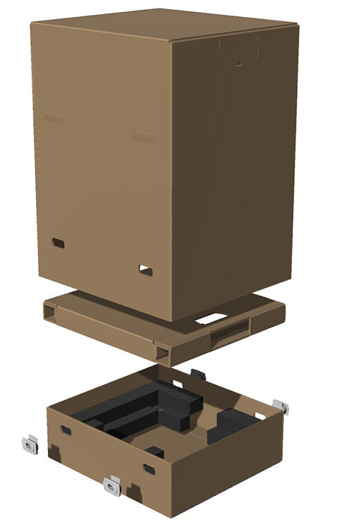

  1. Remove the four plastic locking clips at the bottom of the box. Do not cut open the box at the top.
  2. Slide the outer box straight upward off the printer.
  3. Take out the accessory box (right) and Air Manager filter (front).
  4. Lift the printer out of the bottom tray, with at least two people. Each person places one hand in the handle in the side panel, and another on the back panel for stabilization.
  5. Place the printer on the floor, or onto a flat, level, and stable surface.

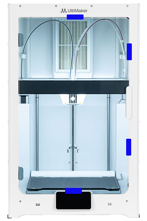

  1. Remove the rubber door seals and open the glass door.

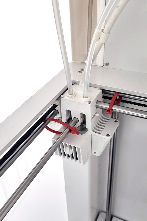

  2. Cut the two cable ties that secure the print head in the back left corner.
  3. Remove the black lens cap from the camera in the front right corner.
  4. Remove the protective film from the touchscreen display.
