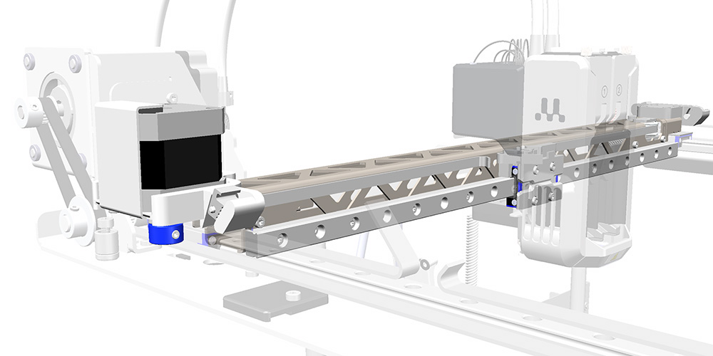

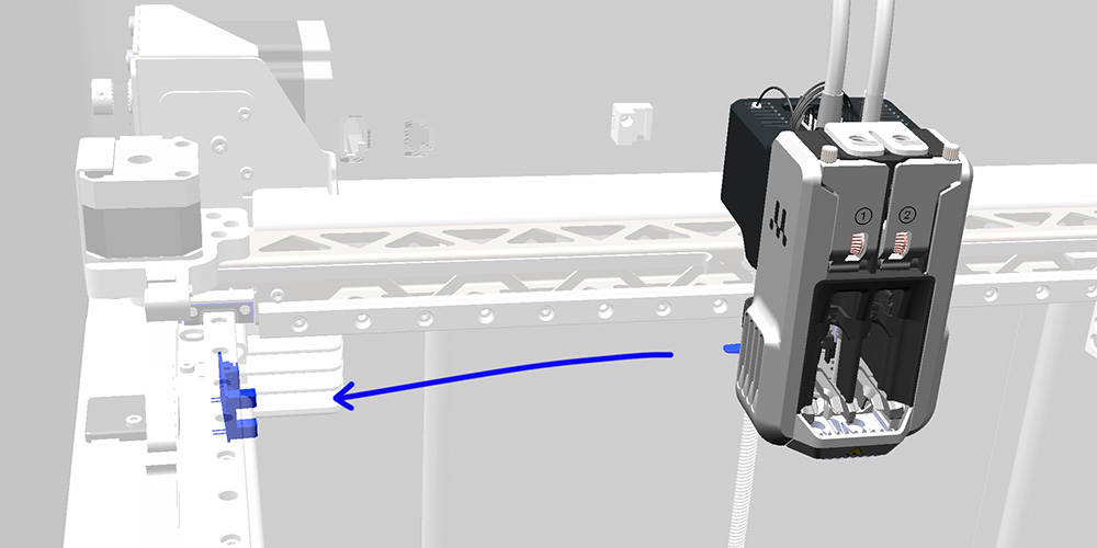

X switch
The X switch is located on the left side of the gantry. It is activated by a small tab ('flag') on the left side of the print head housing.
Potential root cause
Troubleshooting steps
Obstructed switch
Check if there is any object or debris stuck in the sensor. This will constantly keep the switch activated, even though the movements of the print head are accurate.
Manually move the print head toward the right side of the gantry so that you can access the limit switch. Closely inspect the switch and, if necessary, carefully remove any objects or debris with tweezers and/or wipe the switch clean with a cotton swab.

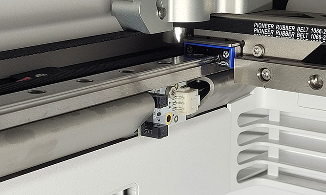

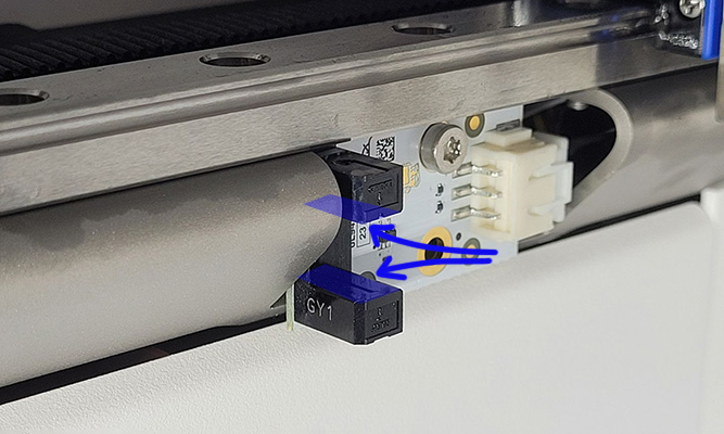

Oil on sensor
Check if excess lubrication from the linear guide rails has dripped onto the sensor. This could affect the functionality, causing the sensor to register as activated. This is one of the most common causes of ER304 affecting the X switch. Move the print head to the right of the build volume to access the sensor and clean it carefully but thoroughly.
Using compressed air (anti-dust spray) is the best way to clean the sensor and solve the issue. Spray from a distance of 20 - 30 cm (8 - 12 in) and aim at the inner surfaces of the black optical sensor (indicated in the right picture). Alternatively, use a cotton swab or microfiber cloth lightly dampened with isopropyl alcohol and wipe the inner surfaces clean.

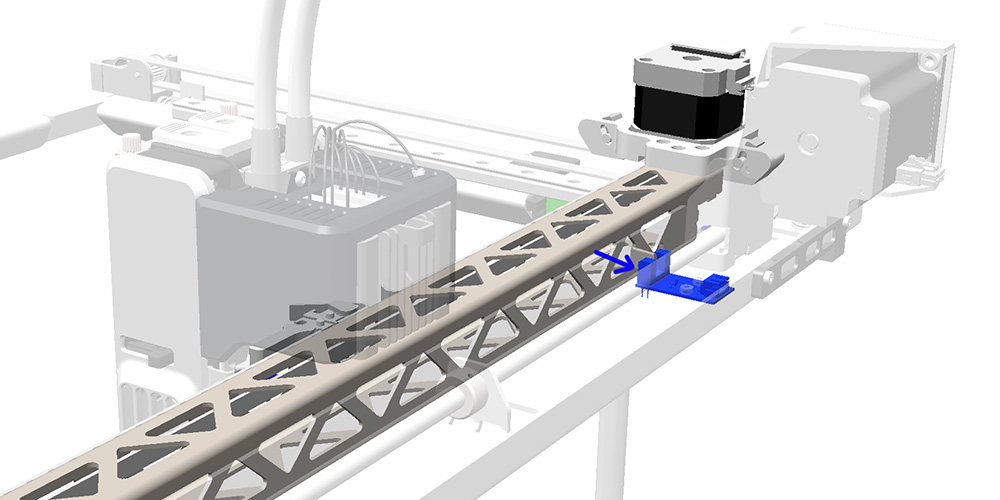

Y switch
The Y switch is located at the back of the gantry, on the left side of the cover. It is activated by a small tab ('flag') at the back of the X beam.
Obstructed switch
Manually move the print head toward the front of the gantry so that you can access the limit switch. Closely inspect the switch and, if necessary, carefully remove any objects or debris with tweezers and/or wipe the switch clean with a cotton swab.
