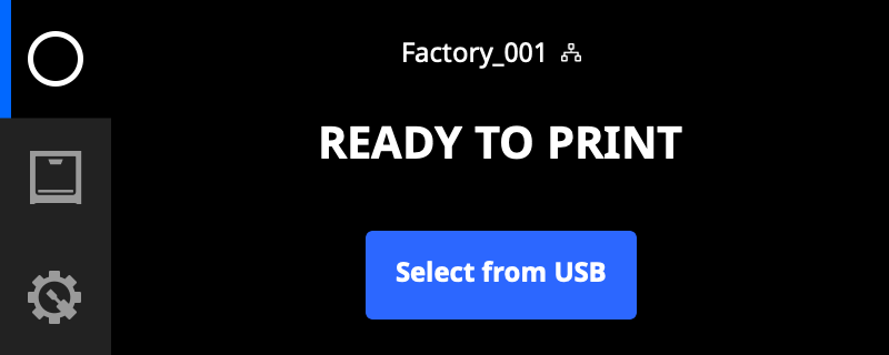

Activating the firewall
To activate or deactivate the firewall, open the Preferences menu (gear icon), select Network, scroll down, and toggle the switch for Firewall.
