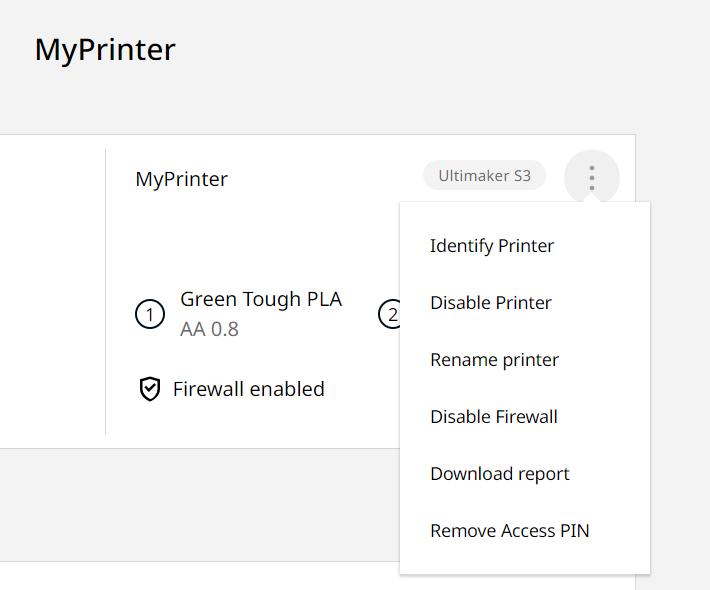

  1. Go to digitalfactory.ultimaker.com to view all printers within your workspace.
  2. Select the printer you would like to protect.
  3. Select Set Access PIN from the context menu (see image below).
  4. Input the PIN code and confirm it.

You can easily remove the PIN code through the Digital Factory. Note that, like enabling the PIN code, removing it can only be done by workspace admins in Digital Factory.
  1. Go to digitalfactory.ultimaker.com.
  2. Select the printer for which you want to remove the PIN code.
  3. Select Remove access PIN from the context menu (see image below).
  4. The PIN code is now removed from the printer.
Anyone can now access the settings menu without the PIN code.
