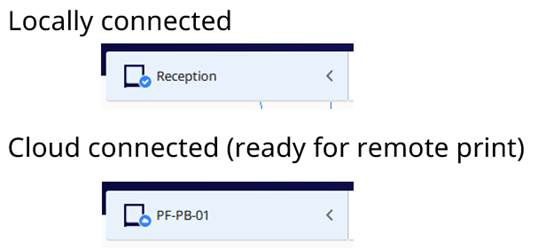

Am I connected to the printer?
Materials only sync from Cura to the printer if Cura is connected to the printer via LAN (Wi-Fi or ethernet connected). You can check this in the following ways:
  1. There is a blue checkmark next to the printer name (not: a blue cloud icon)

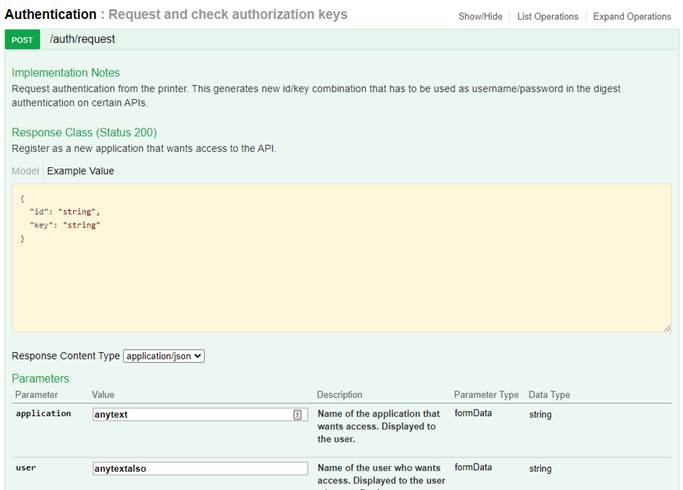

Deletion of Materials via device API
  1. Connect locally in the same network as the printer
  2. Find the GUID of the material using http://Printer-IP/cluster-api/v1/materials/
  3. Go to http://Printer-IP/docs/api/#!
  4. Go to Authentication > POST /auth/request and expand the drop down and fill out the required fields of “application” and “user”.
  5. Press Try it out button
    1. As response, you’ll get an ID and a key that looks like this :
      "id": "16ee143613c53ff860a72003b3b1fb35",
      "key": "7e7f7f149d5d0990f964262c7c241387cdd0a87d797b65de89edf5b52a19bc07"}
      1. On the physical printer itself, you will see your application + user, confirm it on the printer to allow access. Once confirmed, from this point on, you can use the ID as Username and Key as password when you need to do PUT/POST/DELETE API requests.

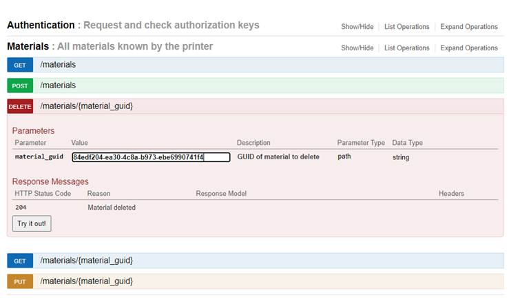

      2. To delete a material, scroll down to the materials category and expand the DELETE /materials/{material_guid}
      3. Put the Material GUID as retrieved in step #2
      4. Press the Try it out! Button
      5. Enter the ID and key as Username and Password respectively as retrieved in step #6 and press submit.
      6. You should receive this as response
      7. To double check, do step #2 again to verify that the material has been deleted

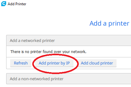

Workaround for now for initial set up
1. For one-time initial setup, make sure that you are in the same network as the printer you want to transfer the material to.
2. In Cura, make sure that you have downloaded the third party materials and you can select them in Cura.
3. In Add Printer > choose Add printer by IP
4. Then enter the local IP address of your S5 printer. You will find this in Network menu on the S5’s printer UI.
5. Once the printer has been added to Cura and it shows you the “check” mark in the icon, then you are connected locally.
(in the image below, we want the Locally connected scenario for this process)
