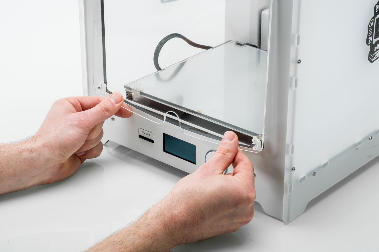

To install the door, follow these steps:
  1. Remove the front enclosure from the packaging and hold it in front of the Ultimaker with the curved side facing down.
  2. Slide the top clips behind the front panel.
  3. Push the front enclosure flat against the Ultimaker, then slightly lower the door until the bottom clips hook behind the front panel.
How_to_install_front_enclosure_for_Utimaker2__Slide_door.jpgHow_to_install_front_enclosure_for_Utimaker2__Push_front_enclosure.jfif

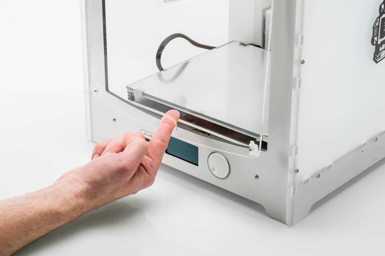

After printing, to remove the door simply lift it up with your finger through the notch in the bottom and pull it towards you.
How_to_install_front_enclosure_for_Utimaker2__Remove_the_door.jfif
