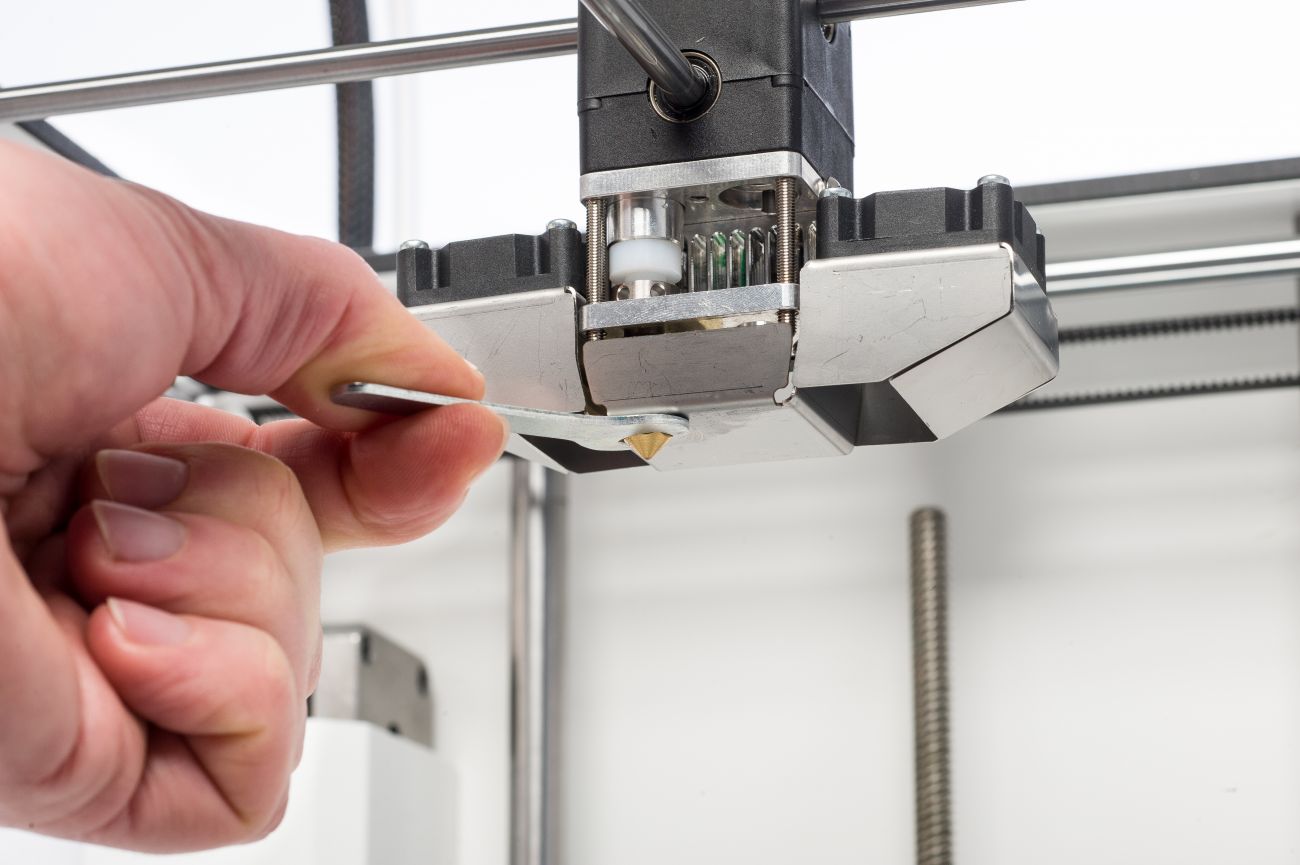

4. Remove the nozzle
Use the 7 mm wrench to unscrew the nozzle from the heater block, in a clockwise direction
Caution: The nozzle is warm. Take proper measures to catch the nozzle when it is loosened from the heater block. Protective (thermal) gloves are advised.

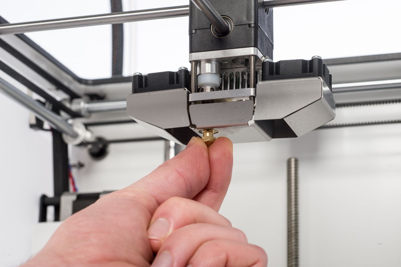

5. Install the new nozzle
Select the desired nozzle and manually screw it into the heater block until it is hand-tight. Finally, use the wrench to fully tighten the nozzle
Caution: Be careful, as the heater block is still warm. Protective (thermal) gloves are advised.
When the new nozzle is installed, exit the Set nozzle temperature menu. You can now reload the material.

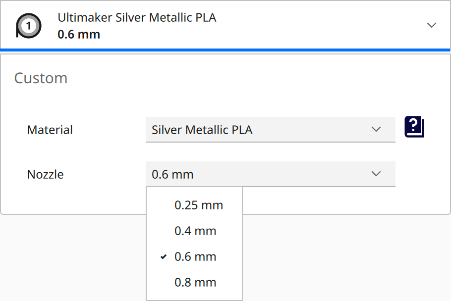

Settings
If a different size nozzle was installed, change this setting in Ultimaker Cura to prepare your next print job. This ensures that all profile settings, such as line width and layer height, are optimized.
