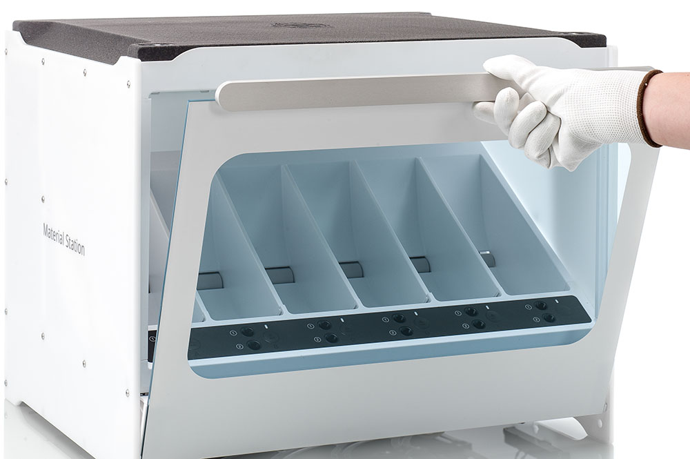

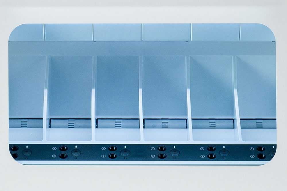

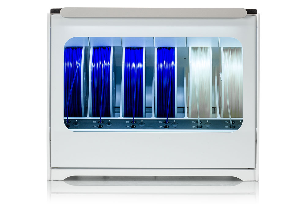

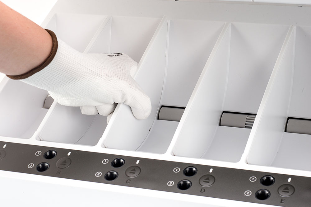

Material bay
One of the six spaces inside the Material Station where spools can be placed. The bays are named A – F. Any spool of material can be loaded into any of the bays, even composite materials (as long as the spools are no wider than 70 mm and have a maximum diameter of 203 mm). To benefit from the automatic spool switching feature, it is recommended to load at least two spools of the same material.
Door
The Material Station door should be kept closed (except when handling materials) to enable humidity control. The door has a sensor; when the door is opened, the display of the S series printer automatically switches to the material configuration overview. The open door is not to be used for placing and storing items, which is why it rests at an angle.

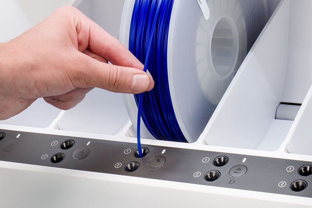

Entry port
Each material bay has two openings, or entry ports, in which filament can be inserted into the Material Station. This determines the configuration of the material. Insert filament into the top opening (1) to guide it to extruder, and into the bottom opening (2) to guide it to extruder 2.

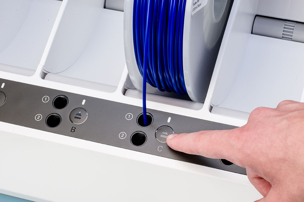

Eject button
Next to the entry ports is an eject button. Press this to unload the filament from its pre-loaded state to remove a spool. The materials in use during a print or parked above the print head are blocked from unloading. Active materials are indicated by a blue light.

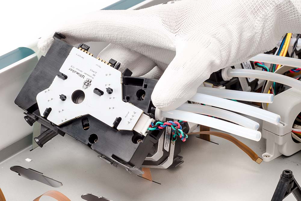

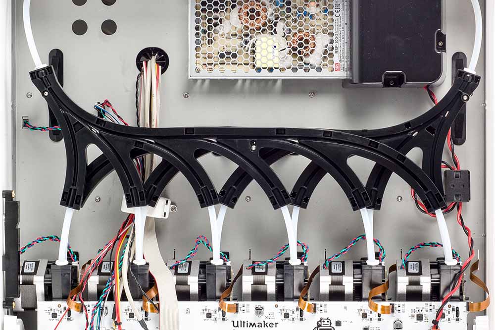

Prefeeder
The Material Station contains six prefeeders. The prefeeder grabs and detects the material during loading and guides the material through the Material Station to the printer's feeder. During printing, the prefeeder does not actively feed, but is activated regularly to reduce stress on the material and ensure consistent extrusion.
Merger
The Material Station contains two mergers. These are guidance systems with six tracks on the front end, and a single one at the back. The mergers connect to the prefeeders and the decouplers and ensure that the filament from any material bay is guided to the required extruder.

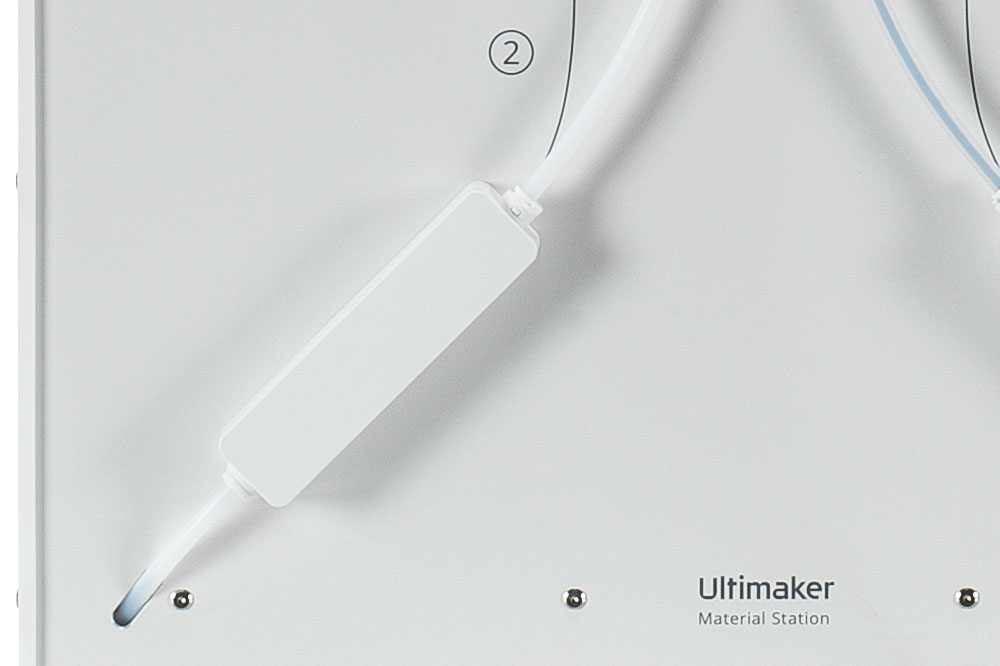

Decoupler
Two decouplers are located at the back of the Material Station. Each decoupler connects to the printer's feeder above it with a Bowden tube. The decoupler contains a spring-loaded sliding mechanism that provides the printer with information about the position and tension of the filament. This is used during loading and printing, but also helps to detect end-of-filament.

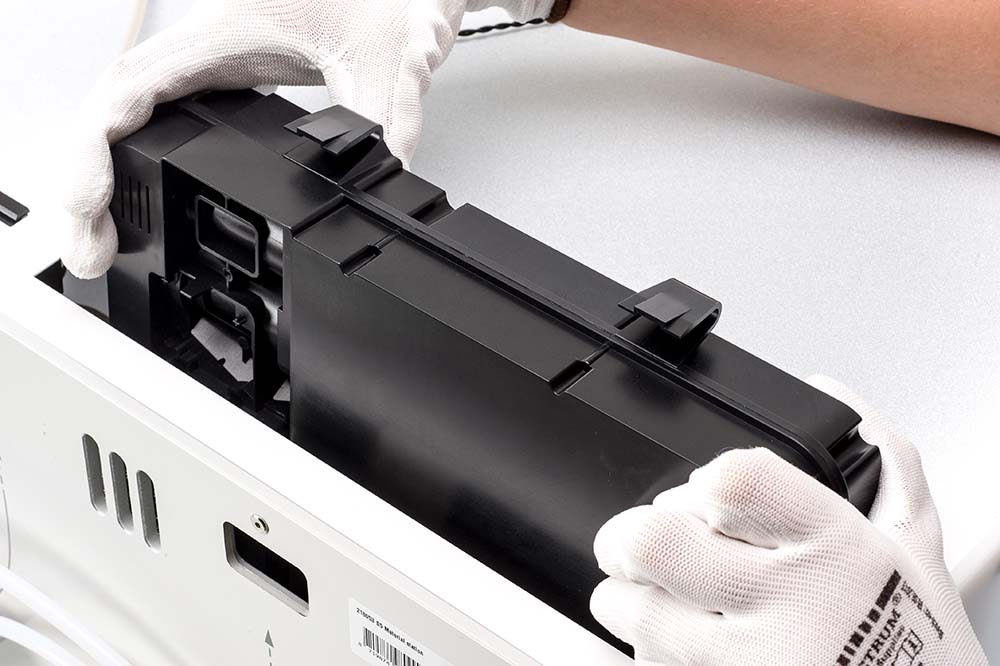

Dehumidifier
The relative humidity inside the Material Station is controlled and kept below 40% to ensure optimal storage conditions for the materials. The dehumidifier in the back of the Material Station contains silica beads that absorb moisture. The dehumidifier then circulates the dry air into the Material Station chamber. When these beads are saturated, they are heated and water vapor is expelled out the back of the Material Station. This regeneration cycle is an automated process and does not interfere with other operations of the Material Station.
