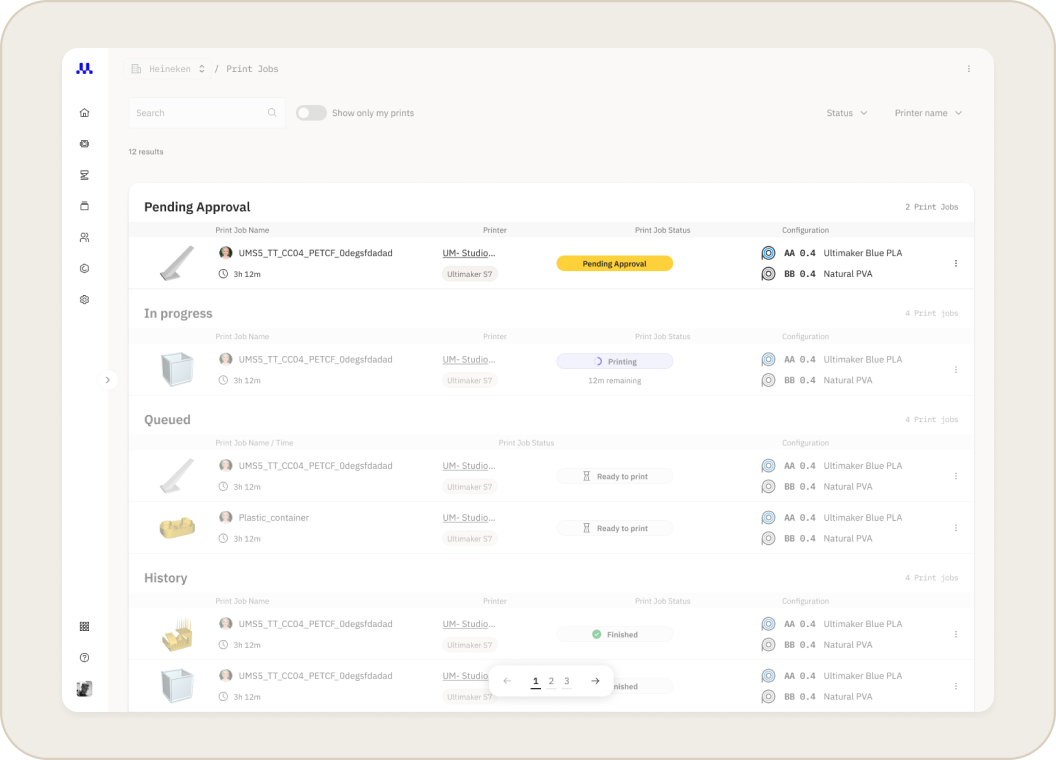

  1. Manage Pending Approvals
    The Pending Approvals section shows any print job that requires approval to start printing
    • Jobs sent by “Guest” or “Student” roles if setting has been applied
Note: For more details, see Manage Print Job Approvals

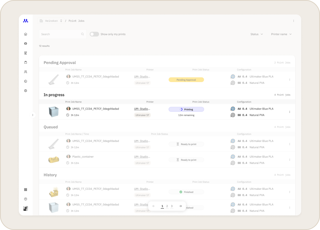

  1. View In-Progress Jobs
    The In Progress section shows any print job that is currently printing.
    • You can see the real-time status, including the estimated time remaining.
    • Finished or aborted prints will also remain on this list until the part is physically removed from the printer's build plate.

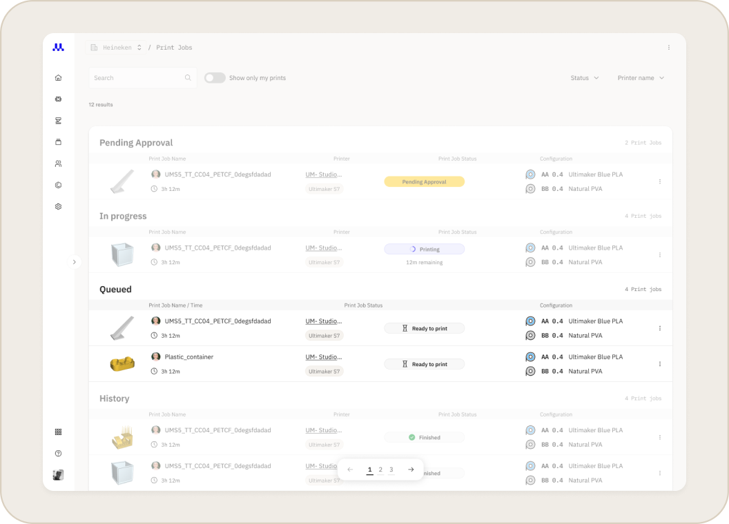

  1. Manage the Print Queue
    The Queued section shows all jobs that have been sent to a printer but have not yet started.
    • A job is placed in the queue if the printer is already busy with another print.
    • Jobs are also queued if they require a material or configuration change before printing can begin.
    • You can reorder jobs in the queue to prioritize urgent prints or remove jobs you no longer need.

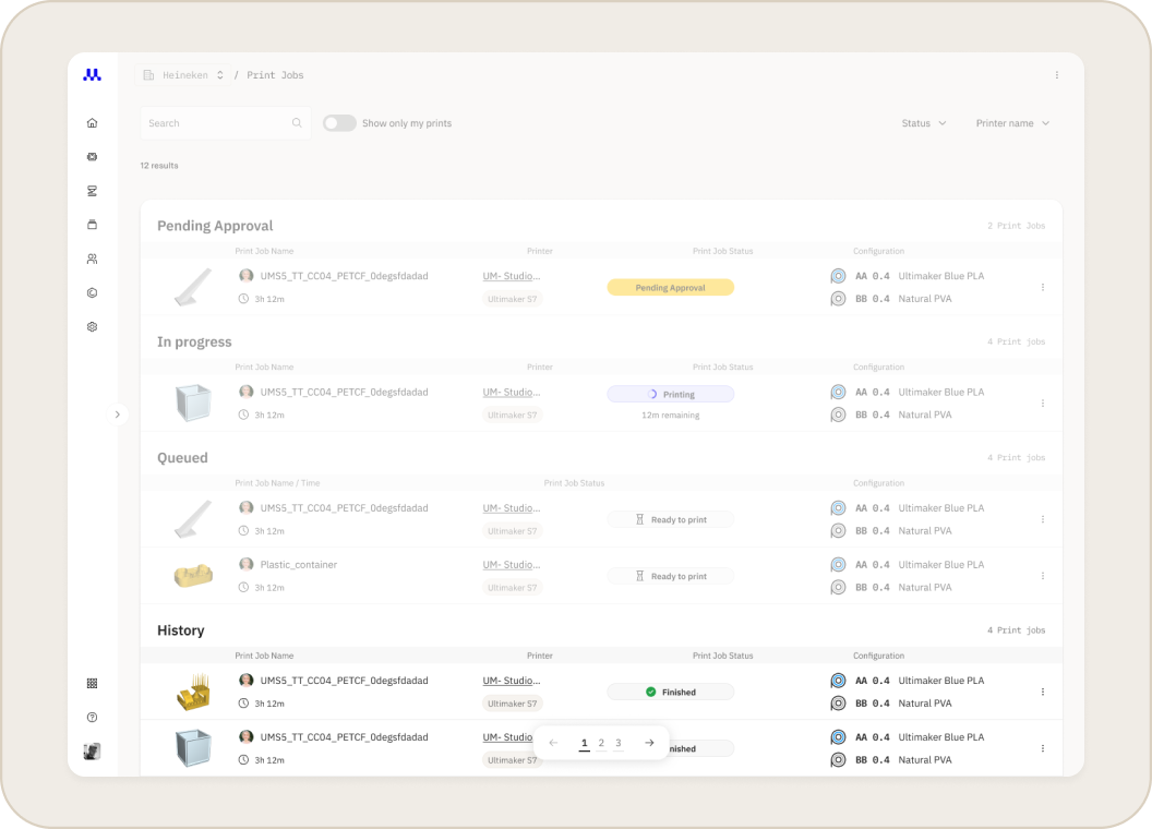

  1. Review Your Print History
    The Print History section contains a record of all previously completed, aborted, or failed print jobs.
    • Free PRO/EDU: The history shows the last 20 prints for each printer.
    • Paid Plans (Studio, Classroom, Business, School) : Unlimited print history is stored.
Search and Filter (Paid Tiers only)
You can search for individual jobs or filter by owner, status, or printer name
