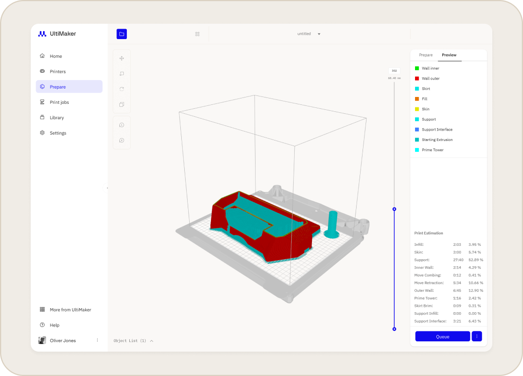

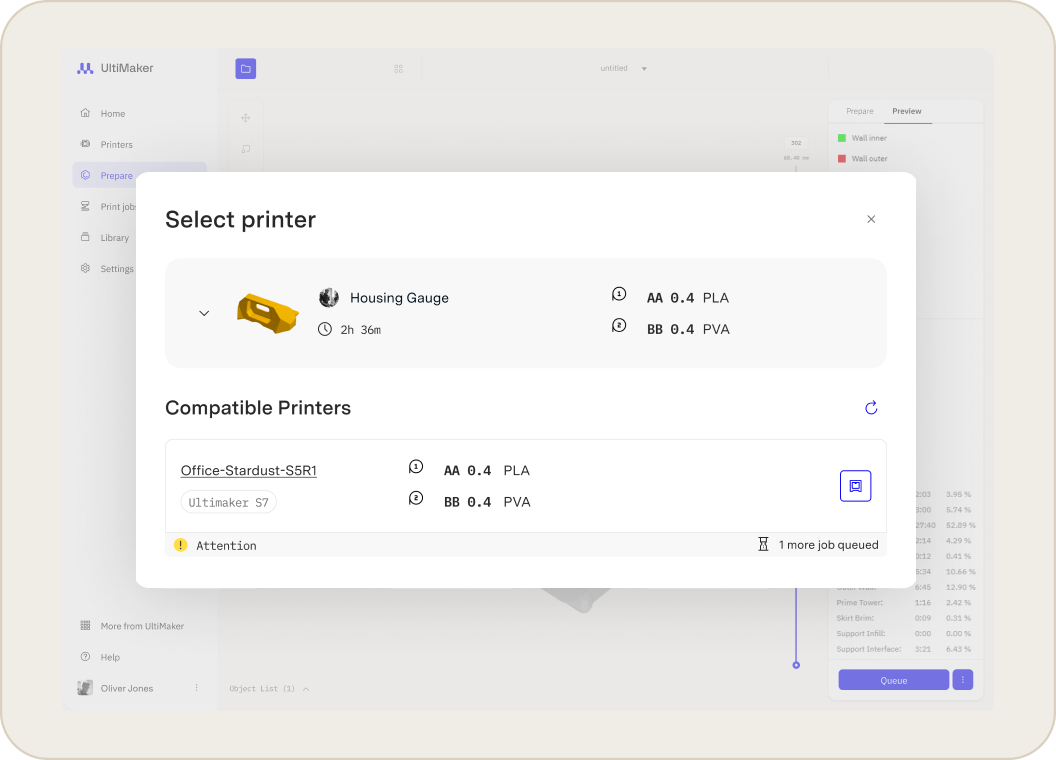

  1. From the Prepare section: After slicing a model with Cura Cloud, you can send the job directly to a connected printer.
  1. From Library: You can select any pre-sliced .ufp file in your Library and send it to any compatible printer in your workspace. This is perfect for reprints or running jobs prepared by team members.
  2. From Cura Desktop: When using UltiMaker Cura, clicking Print via Cloud sends the job directly to the printer through the Digital Factory.
