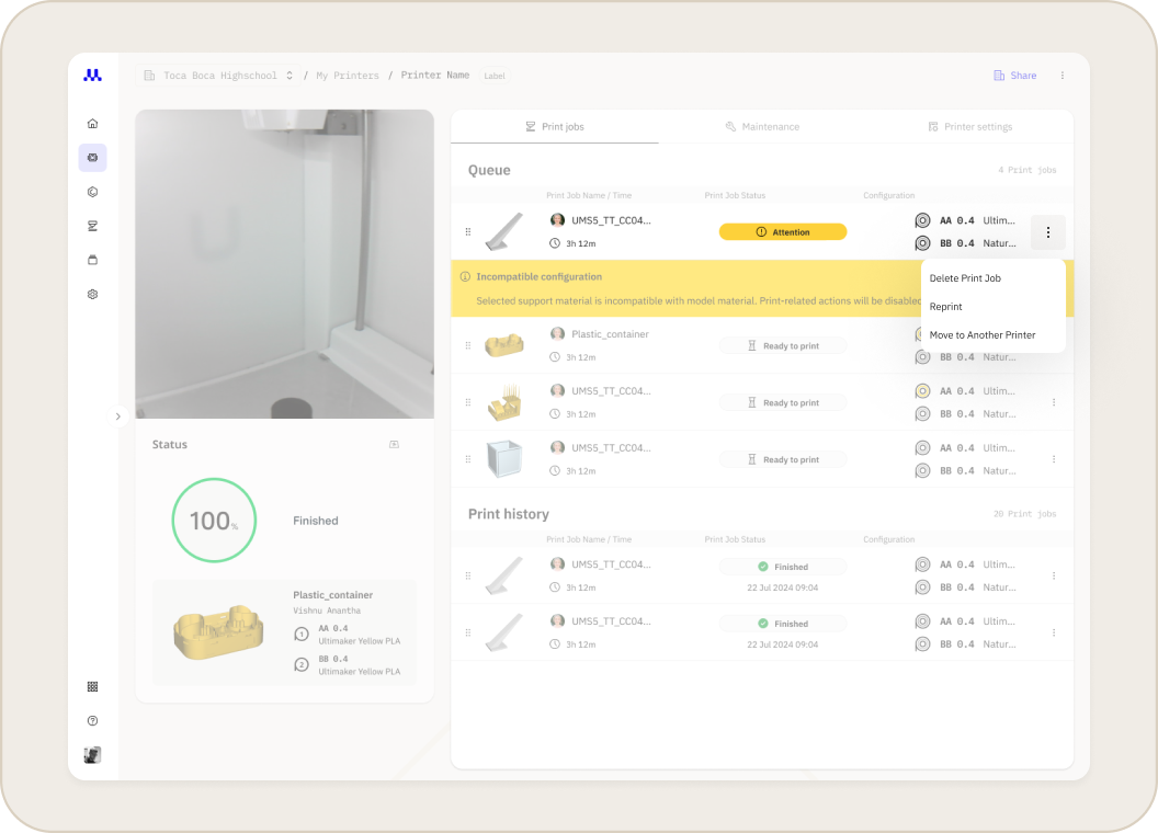

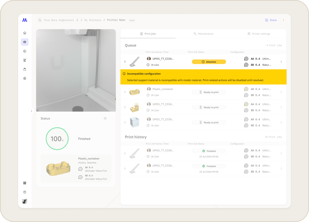

When you send a print job to a printer, the job is prepared with a specific combination of materials and print cores. If the printer is currently set up with a different configuration, the print job will not start. You will see an Attention notification in the Digital Factory print queue and a message on the printer's display.

1. Change the Printer's Configuration
The printer's display will show a Conflicts screen that tells you which materials or print cores need to be changed.
  • Follow the instructions on the screen to update the printer's physical configuration.
  • Once the materials and print cores match the requirements of the print job, the job will be able to start.

2. Move the Job to Another Printer
If you have another printer that is compatible with the print job's configuration, you can move the job to that printer.
  1. Click the three dots next to the blocked print job.
  2. Select Move to Another Printer.
  3. Choose a compatible printer from the list in the pop-up window.
