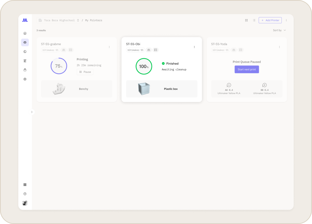

Follow these steps to confirm a build plate is clear. This option is only visible when the printer is in the Awaiting cleanup state.
  1. Navigate to Printers
    • Log in to your UltiMaker Digital Factory account.
    • From the main menu, go to the Printers overview page.
    • Select the printer that shows the Awaiting cleanup status.

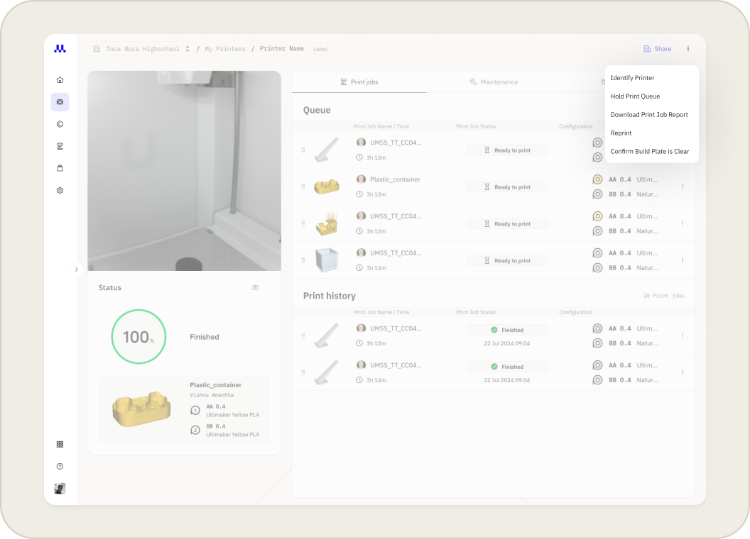

  1. Open Printer Options
    • Click the three dots menu (...) in the top-right corner of the printer's detail panel.
  1. Confirm the Build Plate is Clear
    • From the dropdown menu, select Confirm Build Plate is Clear.

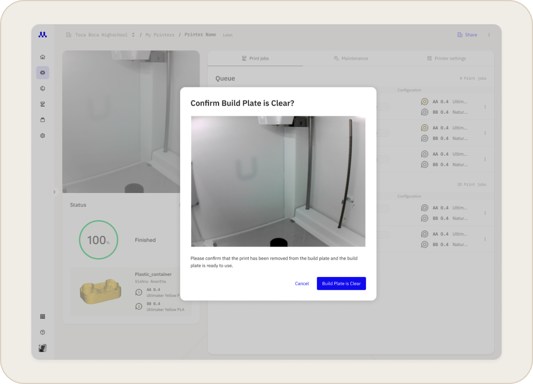

    • A pop-up window will appear showing the printer's live camera view. Use this to visually verify that the previous print has been removed and the build plate is correctly in place.
    • If the printer is ready, click the Build Plate is Clear button.
Once confirmed, the printer is ready to accept the next print job from the queue.

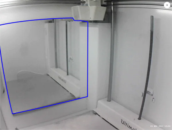

  • Camera View: On certain printers including UltiMaker S3 and S5, the camera may not show the entire build plate when it is in the lowest position. Placing a small mirror inside the printer's left panel can help reflect the full build plate surface.

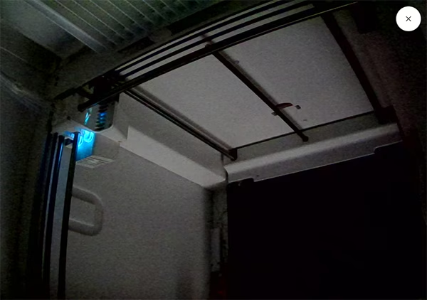

  • Lighting: If the printer is in a dark environment, the camera may not provide a clear view. If you cannot see the build plate clearly, do not confirm removal remotely. Go to the printer to check it in person.
