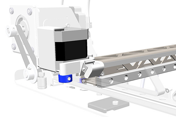

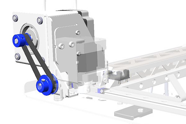

Check the pulleys
Ensure that all pulleys are securely tightened. In particular, check the pulleys connected to the motors. For the Y direction, also check the pulleys on the motion shaft at the back. If any of the pulleys are loose, use a Hex 2 screwdriver to tighten the set screws.

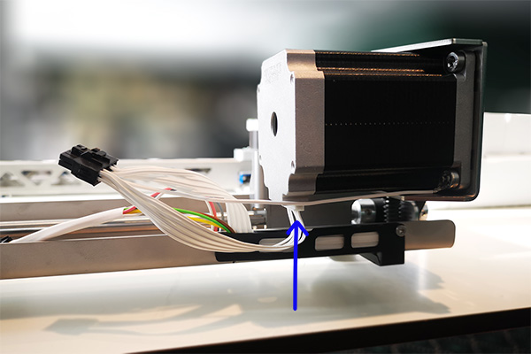

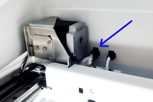

X motor cable
To reach the cable connected directly to the X motor, the gantry system must be removed from the printer. You can find the instructions here.
The X motor connector is at the back of the motor. Check if this is securely connected and reconnect it, if necessary. Also inspect the cable for damage.

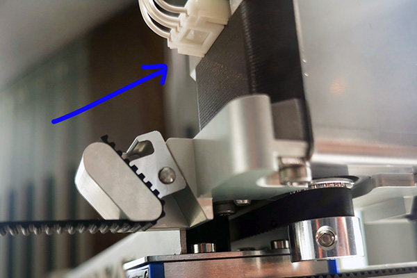

Y motor cable
To reach the cable connected directly to the Y motor, the gantry system must be removed from the printer. You can find the instructions here.
The Y motor connector is at the bottom of the motor, you can reach it from the back of the gantry. Check if this is securely connected and reconnect it, if necessary. Also inspect the cable for damage.

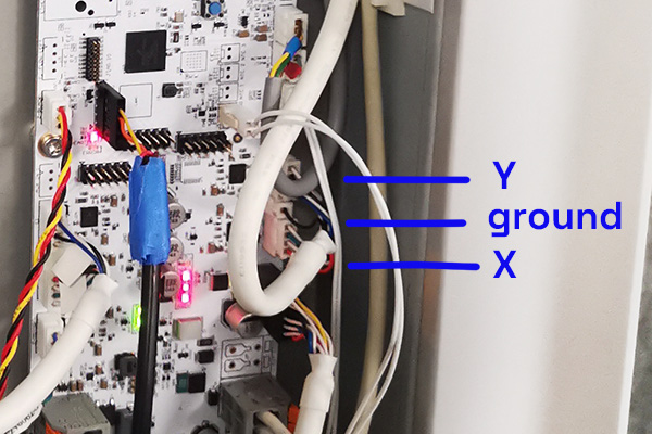

Electronics XY
The gantry motors are connected to the mainboard. To access this, the back cover panel must be removed*.
The X and Y motors are connected on the right side of the board (as seen from the back). Ensure these cables are connected properly, and reconnect them, if necessary.

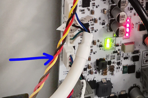

Electronics Z
The Z motor is connected to the mainboard. To access this, the back cover panel must be removed*.
The cable of the Z motor connects on the left side of the board (as seen from the back). Ensure it is connected properly, and reconnect it, if necessary.
