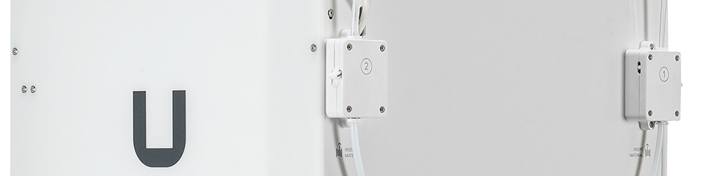

The feeder versions look identical from the outside. However, there are several ways to know which feeder type you currently have. Firstly, you can check your serial number.

    You can open the feeder to check the pattern on the knurled wheel. You will need to remove the front part of the feeder housing, as when cleaning the feeders. Reduce the feeder tension and remove the Bowden tube before proceeding. Use the hex screwdriver to remove the four bolts that secure the feeder housing and pull away the front part. Check the pattern on the knurled wheel:
