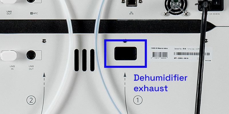

  4. Check for damage. Especially if the ER67 error occurs on a new machine, or after relocating the Material Station, the dehumidifier and/or exhaust may have shifted. This is not a normal occurrence and would only happen in case of rough transport. Check the back of the machine if the exhaust is still correctly positioned. If it is not, or for more information, please contact support.
