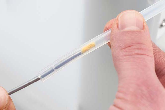

To check the tube, unload the material. To be able to inspect it better, you may have to clean the Bowden tube first. Check if you see any visible scratches on the inside of the tube.
Additionally, you can remove the Bowden tube from the print head and feeder side and push a length of filament through manually. If you feel excessive friction or obstructions somewhere along the tube, this is an indication that it should be replaced.

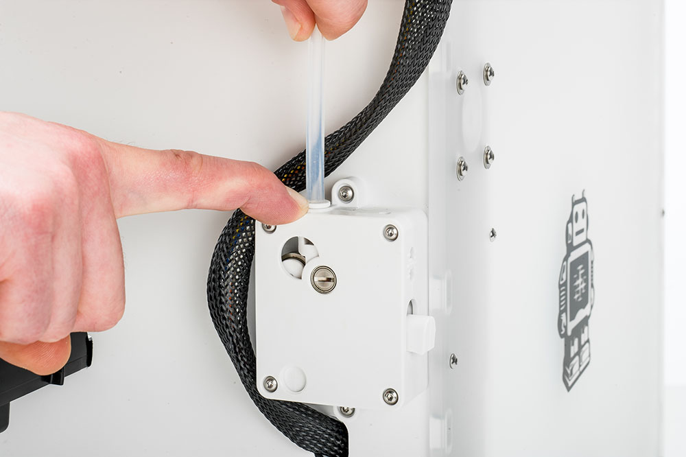

After removing a Bowden tube multiple times, the tube coupling collet can leave scratch marks on the outside of the tube. This can reduce the collet's grip on the outside of the Bowden tube. In this case, the Bowden tube can slightly move up and down during printing and retractions, which negatively impacts the print quality. It may also lead to the Bowden tube coming out of the feeder.
With the Bowden tube installed and secured with the clamp clip, pull the Bowden tube above the feeder as well as the print head. The tube should remain securely in place. If there is noticeable play (> 0.5 mm), inspect the surface more closely.

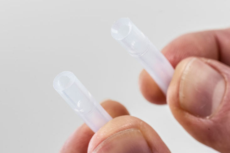

Remove the Bowden tube from the print head and feeder sides. Inspect the surface where the collets grip the tube. It is normal that there is a small ridge or line visible. However, if the surface looks very rough or worn down, it is recommended to replace the Bowden tube.
