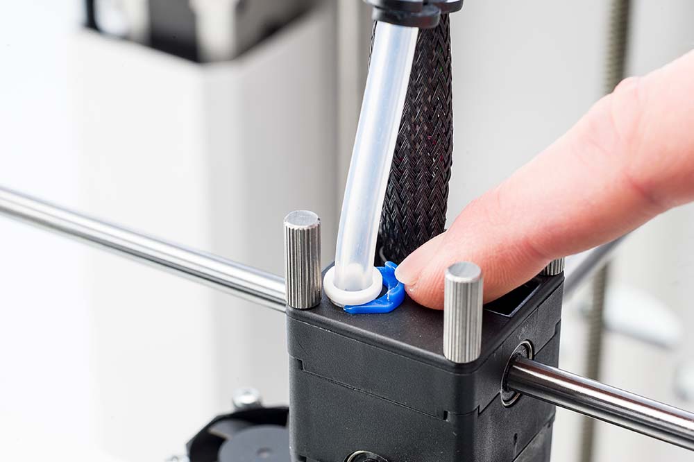

2. Remove clamp clip
Place the print head in the front-right corner for easier access and remove the clamp clip from around the tube coupling collet. Also remove the clamp clip from the feeder.

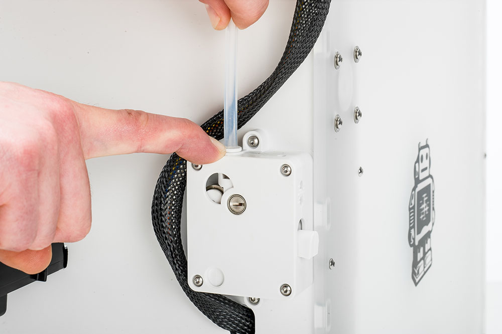

3. Remove Bowden tube
Press down on the tube coupling collet while pulling the Bowden tube out of the print head. Repeat this for the feeder.

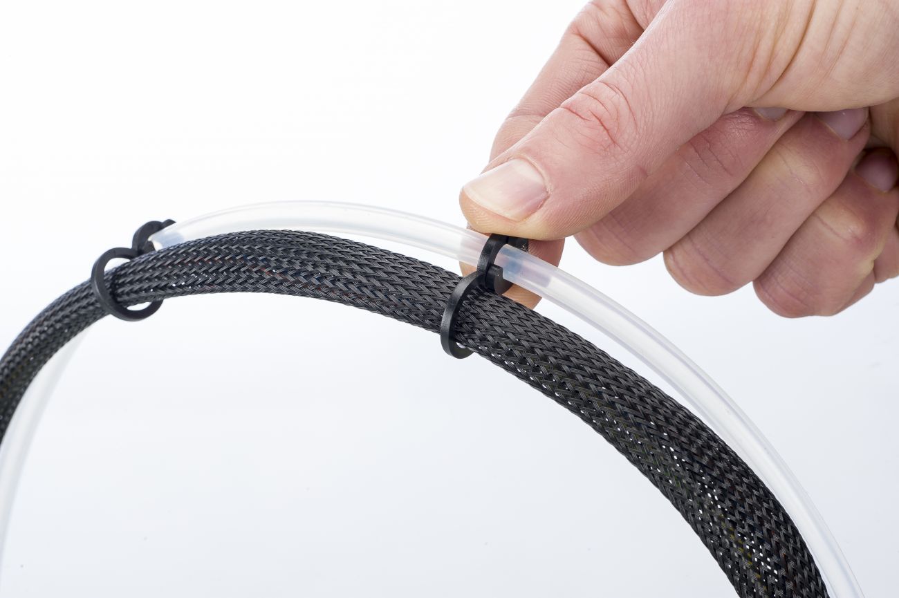

4. Loosen cable clips
There are five cable clips securing the Bowden tube to the print head cable. Click them off the Bowden tube.

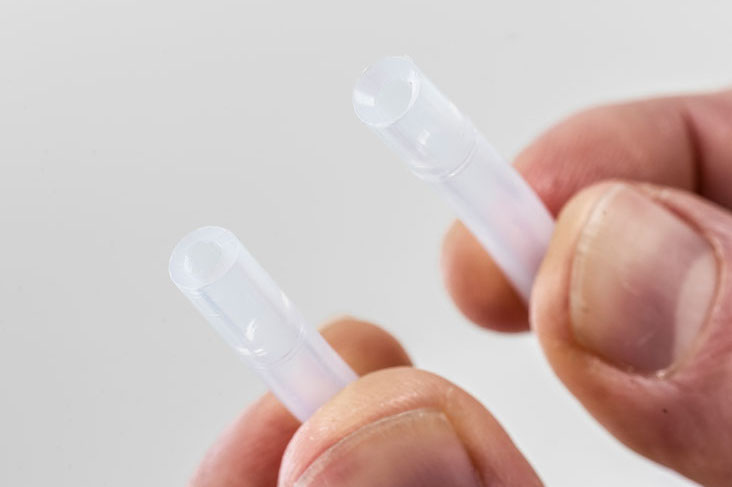

1. Note the two sides
Take the new Bowden tube and check the two sides. Older Bowden tubes may have one flat and one chamfered side. The chamfered side should be inserted into the feeder so that the filament enters the tube smoothly. The flat side goes into the print head.
Tip: If both sides are chamfered, the orientation does not matter.

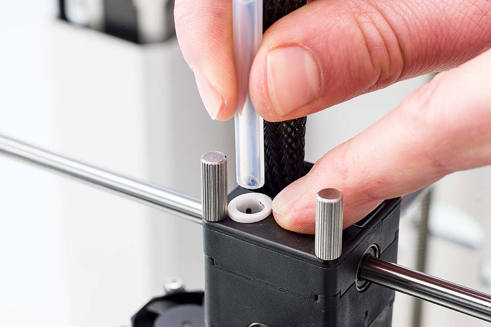

3. Insert into print head
Insert the other side of the Bowden tube into the print head. Keep the collet pressed down and push the Bowden tube all the way in. Secure the tube with the clamp clip.
4. Place cable clips
Click the print head cable clips onto the Bowden tube. Equally divide the clips over the Bowden tube, starting at ~10 cm above the print head.

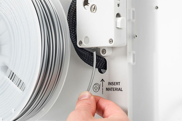

5. Reload material
Turn on the printer. Reload your material either via Material → Change, or via Maintenance → Advanced → Insert material.
