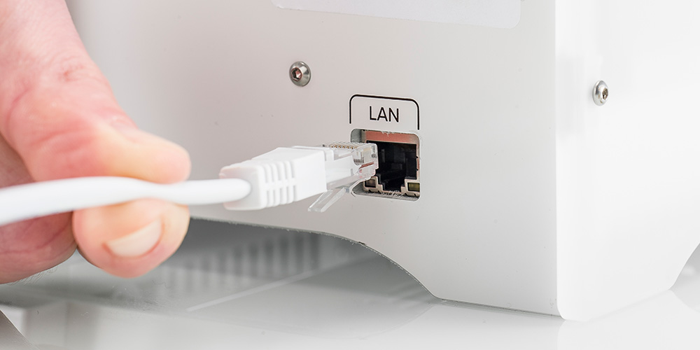

Ethernet
To connect your printer via the Ethernet cable, simply connect one end of the cable to the port at the back of the printer, and the other side to a network source (router, modem, or switch).
